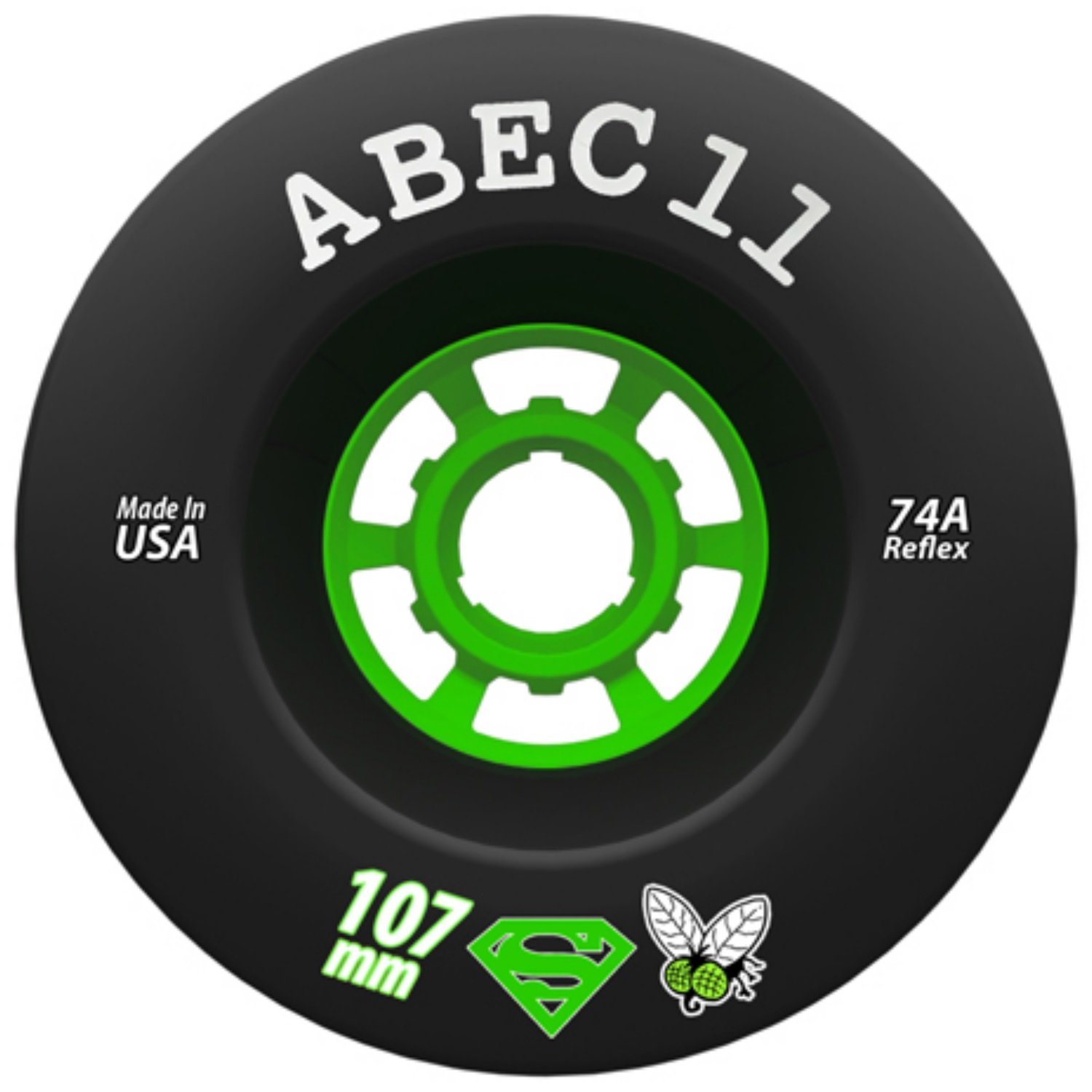

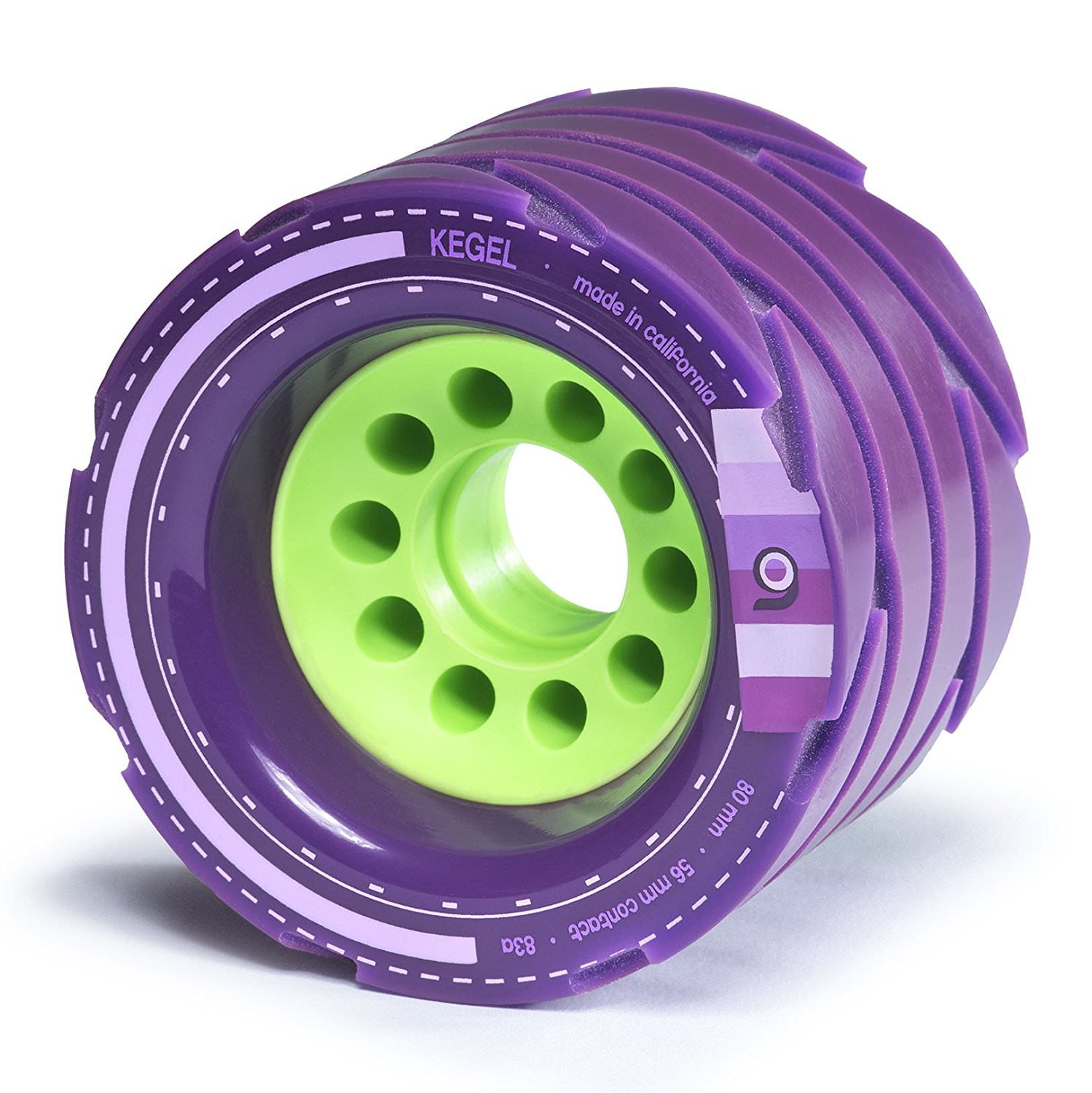

Wheel Core: Encircled by material such as urethane. Common Core types are Kegel - circular holes e.g “Torqueboards 110” and Abec - slotted holes e.g “Abec11 Superfly”. Pulley systems will connect to the wheel core.
