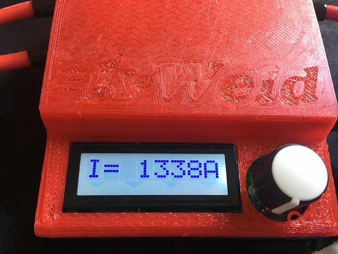

Here is the calibration results with this Turnigy nano-tech 4s battery
The battery can supply 1338A to the welder, anything over 2000A will not pass calibration, the resistance value is a low value of 2.22, I did a good job on the electrode assembly it seems :slight_smile:
For the standard kWeld cable / electrode holder / electrode assembly, the value should range between 2.5and 3.0 milli-Ohms

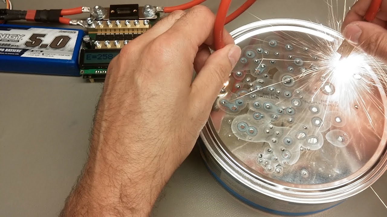

This is what I was playing with before. Was expecting to blast holes in the cell at them settings
Can you measure the amps delivered and resistance met with a test?
Some batteries appear to have aluminum cans. I have had a customer who had sent me a few samples for testing, and I could confirm that it is not possible to weld nickel strips to these with kWeld, even when cranking up the current to 1700A. You’d probably need laser welding for these.
And, as magharees suggested, keep the foot pedal down to tell the amperage. That’s the best indication of a problem with the setup. Also make sure to calibrate properly: make sure the electrodes are clean, and press the (conical areas of the) tips together hard during the SHORT step. You shouldn’t see any sparks, otherwise repeat. Make sure that all nuts and bolts are tight. Also check the electrode set screws, but don’t overtorque because that is all copper.
