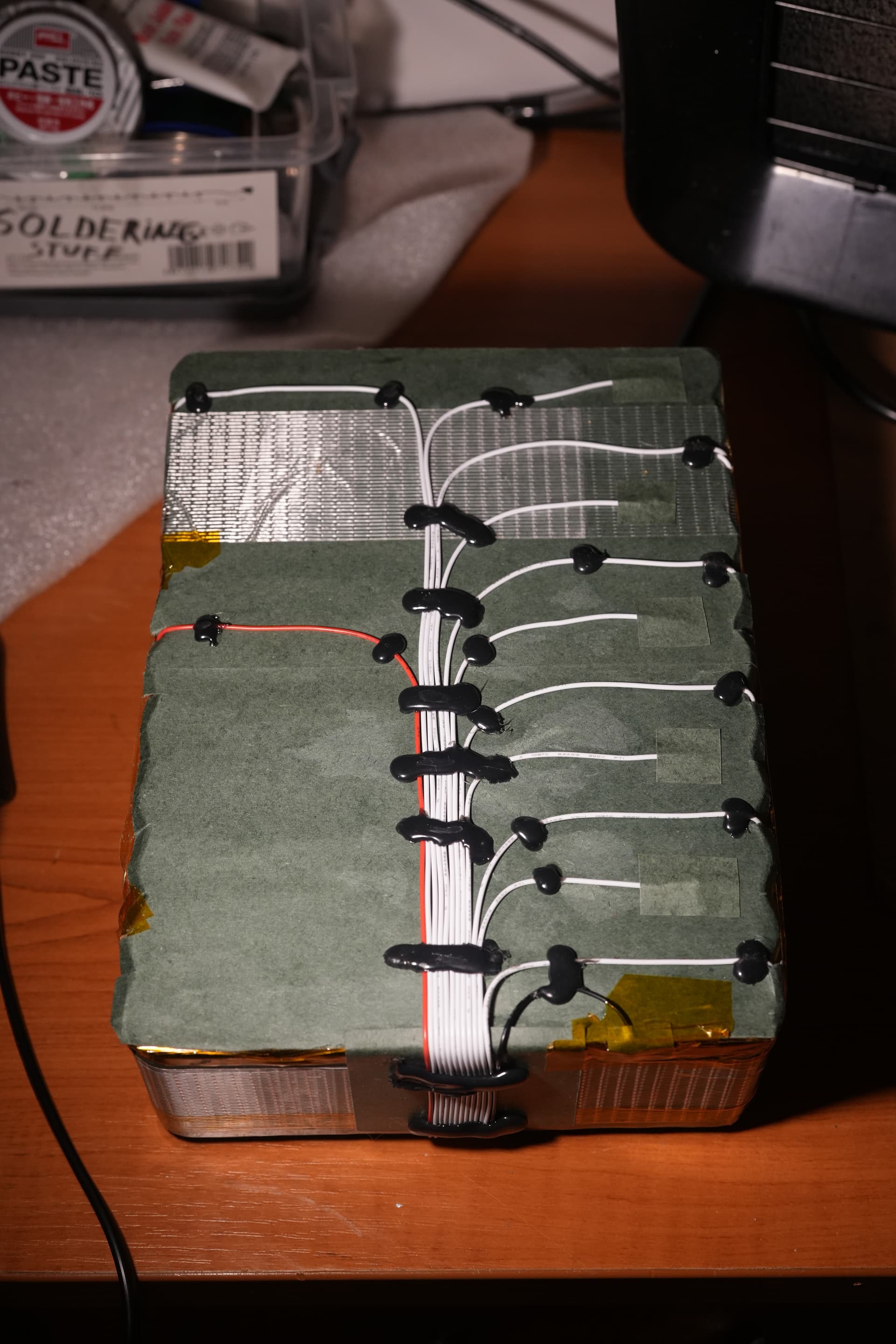

The characteristics of a brick pack
A brick pack is one of the more easy battery pack shapes to make, because there is no flex to worry about, meaning you can weld the cells groups directly to one another. However, this also presents some challenges, because brick packs are heavy, and can easily have the welds broken off if nothing else is holding the cells in place. They also require careful gluing to make sure they end up rectangular, and not skewed.
If the space and capacity requirements allow for it, I highly recommend using plastic cell holders to keep the battery in tact. You can get these in both grid and staggered configurations. These solve the hardest problems when building a brick pack, so please consider these / custom 3d printed cell holders as an option!
In this tutorial we will be building a pack without these, because I wanted to cram the biggest battery as possible into my mountainboard enclosure. I will be building an 12s8p 21700 pack with the last group and BMS stacked on top for a more narrow footprint. I am using reclaimed cells, so please ignore the markings on the cell ends.
Ready? Let’s go!

Step 5 - Adding the BMS
  1. Make sure there is plenty of fishpaper insulation between the BMS and the battery
  2. Use hot glue / tape the BMS to the battery pack.
  3. Route the balance wires along the battery, using hot glue to keep the wires in place and in order. You can route the wires on the side of the battery between p-groups to protect them. If you need to cross any balance wires over one another, put fishpaper between them so that they cannot rub against one another can cause a short.
  4. Double check that your balance wires have not changed order before you shorten them and solder them. This is an annoying mistake to fix if you make it.
  5. Use an exacto knife to cut through the fishpaper and kapton tape to make a small hole available to solder the balance wires to the nickel between the p-groups.
  6. Cover the solder spots with fishpaper or hot-glue to insulate it again.
