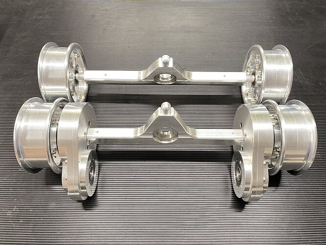

Things are starting to arrive. This just came in.
2 things. It’s a piece of art and it’s huuuge. @3DServisas
For a size reference. Hummie deck
I’ve ordered tyres long time ago. But the store has somehow managed to ship it to a different country to the city that has the same postal code as mine :man_facepalming:
My deck and enclosures are still at customs @EboardSolutions beleivebit or not :joy: so quite possible they will get back shipped to you. But I’ll let you know.
@Acido should be making battery soon.
So the fun should start soon :muscle::muscle::muscle:
sick trucks! i didnt see those on @3DServisas website in unanodized aluminum, did you have to get those made custom?
https://shop.3dservisas.eu/products/custom-anodizing-color
Just go to that page and in dorp down menu select RAW - Finality, and the best part. Raw finish is free of charge :muscle:

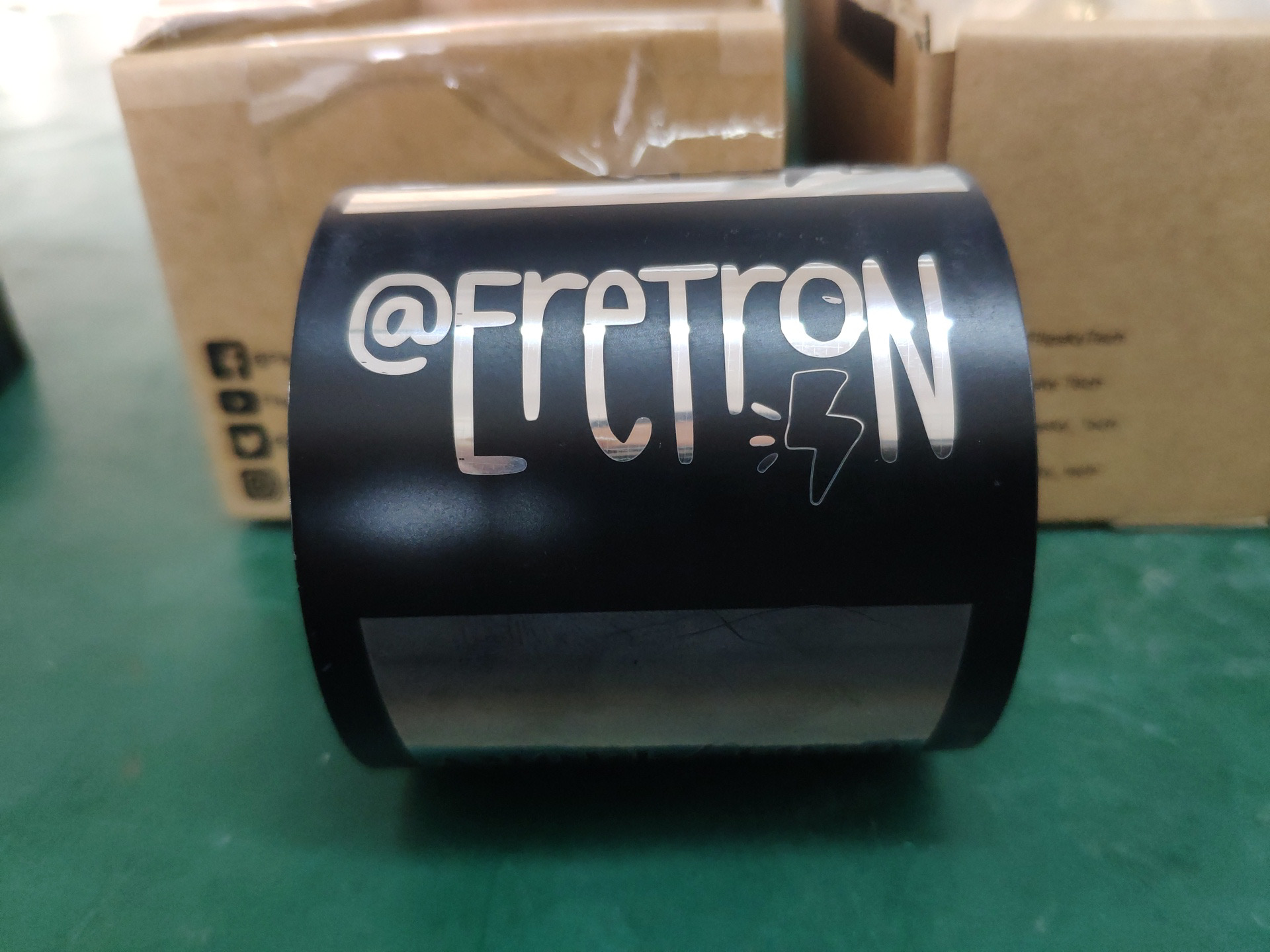

Next was a sanding of the motors to get them to look like raw finish of the finality drive. It came up better then I expected to be honest. Much better fit than the black one.
