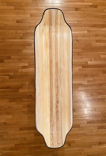

Yeah. I was really surprised. I have plans for a natural look deck in future definitely. But for this one it wouldn’t look nice.
It’s like pulling the carpet back and discovering an original hardwood floor underneath.
@EboardSolutions please offer a DIY deck/enclosure option in a finished wood! It looks amazing.
yeah I was considering doing a transparant topsheet aswell, I like it too! Maybe a bit to light?
did you remove the glassfiber topsheet aswell?
Indeed, maybe see if some varnish or oil make the wood a bit darker but still pops.
I don’t know about the issue of oil and glue on wood tho
Yes I did. I am fairly light guy 79kg and will do print fabric with epoxy on top. So It should be good :muscle:
How about a transparent topsheet combined with some split angles. Maybe 35’ in the front and 25’ in the rear?
yeah transparatn topsheet is what I was thinking :slight_smile:
Not sure yet about split angles
…ya I just used a flat white primer
But that raw wood is so sexy :star_struck:
