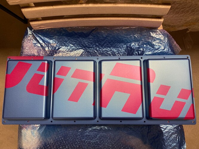

Next was painting it. Blue - Purple color scheme was the way to go, made OutRun cutted on vinyl so I can make my idea come true. I really didnt bother with the finish of the bottom side since 90% of it will be covered with the enclosure and trucks.
So a layer of blue
Vinyl sticker
Layer of purple
Remove vinyl
There you go.
It was time to finish enclosure.
The process was the same just with reversed colors order
This way once the enclosure is mounted you can clearly read the OutRun written
