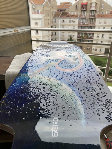

I wanted a custom designed deck, so after a fair amount of revisions and renders I came up with this design:
Printed it out on a canvas
Sanded the deck before painting it white to get a better colour as a base before applying canvas
Made it white
First layer of epoxy
Removed the excess material, applied a few more layers of epoxy, and now waiting for grit to arrive. Huge shoutout to @BigBen for forwarding the packages to me. You are a lifesaver.
