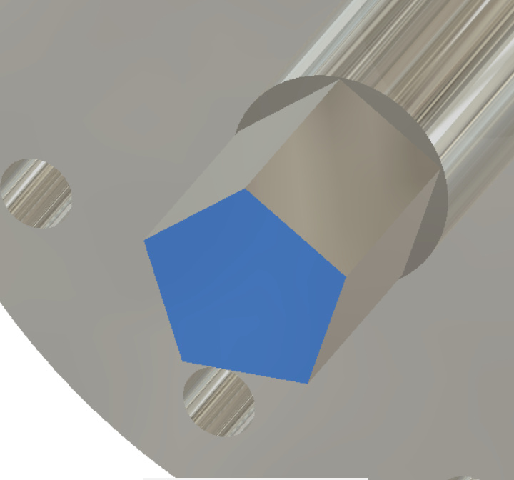

Once I get some feedback from Mike and others the design will be finalized and sent to fab. The current iteration of the design looks like this:
Hanger axle on the left, matched front axles on the right.
I know - these are 10mm across the entire length of the axle. If there is enough preference a stepped axle version could be made. Something like this for 608’s.
22mm of axle with 13mm of thread.

The one thing I’m scared of is this being a somewhat permanent solution. If with a wrench and a sudden rotational impact the axle can come loose (think, secured with blue loctite), then I think a sudden bump while riding or impact could do the same. Or, if you use red loctite, then removing the axles for different ones requires heating them up.
Then again, can’t imagine most people often changing from 1 axle size to another, so let it be permanent :slight_smile: So fucking cool!
A good wrench with a strong arm, green loctite on the grub and blue on axle…it ain’t coming loose.
Just an idea: if you use mounts that have cross bars, these bars will eliminate loose axles because they prevent the axle from turning ( each axle is tightened on opposite direction to each other). Am I onto something?
For that extra security, yeah, but I put loctite on the grub and axle last night, and jumped up and down on it today. I promise you it won’t move.

I have concerns about loosening as well.
Loctite is a solution, but I’d really like to have a purely mechanical solution as well.
The prototype has six faces for the grubscrew to grab, I feel like this is too many. I’ve gone and reduced the number of faces to five.
Two reasons for this.
First, if the grub slips even slightly the axle can begin to rotate out. If there are fewer faces the axle cannot rotate as much with the same amount of grub screw slip.
Second, the threads that engage the hanger are M8x1.25 For every 1/5 rotation the axle will back off the hanger by 0.25mm (1.25/5=0.25) So if we have to back the axle off the hanger by a maximum of 0.25mm to make sure the grub screw engages a flat instead of corner I’m willing to take that trade.
When the TKP hanger and the engagement surface are parallel the distance between the planes is 5.536mm. An M5x6 screw should almost touch the hanger when properly aligned. Loctiting this screw should lock the axle into place.
I’m not married to this pattern though. A more constraining one looks good as well.
I need to do the math on this a little more to optimize the grub screw length. Thanks for making me think about this some more!
Yes, crossbars should help so long as they are stiff enough. I’m thinking that the ideal pattern here would be a triangle - one crossbar between the motors and hanger and two outside the motors forming an isosceles triangle. That should reduce or prevent the torque you’re describing.
