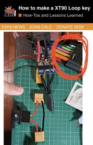

Hey guys, i have not seen a dedicated thread for a loop key tutorial so since i was making a couple yesterday, i decided to snap pics of how i did mine.
What are loop keys?
Loop keys are a budget friendly option for an on/off switch for your board. It’s also a physical disconnection of your circuit and is proven to be the most reliable switch alongside the AS150 connector.
Some antispark switches may eventually burn out or have other issues like a small current draw which eventually drains your battery pack even when off.
Why should you use a loop key?
If you are a college student on a budget, and can’t afford $40 for an antispark switch, a loop key circuit would cost you aroooound $5 US give and take.
Some pics of the wiring and how it works before we start
Ok let’s do this. I will be using a 3D print for the loop key made by @ervinelin on the builders forum. I find that this is the cleanest loop key design that also gives an area where you can pull easily.
Model here :
Here’s what you need for the loop key section
A Male XT90 and a female XT90S
About 4~5cm of 12AWG silicone wire
Do note that the female connector has a green L on the connector. It’s a resistor that kinda acts as a fuse as well in case you decided to mess up your battery polarity yea that happened to me
Good thing is that the loop key and male connector will be the one that pops, and hopefully everything else will be fine. Do not use a female XT90 without the resistor as a loop key.

Now that the key is done, you need to wire up the connectors that goes in the middle of your battery and ESC.
You will need a male XT90, which connects to the loop key, and a female and male XT90/XT60 (depending on which connectors you use)
There was a discussion on which side the loop key should be, either on the negative side of positive. I find that there’s no difference since the loop key acts as a physical disconnection so i placed mine on the positive.
Once you are done soldering, you will need to mount the XT90 onto your enclosure. You can JB weld it @b264 style onto the enclosure, or you can 3D print a mount for it. Here are a few options.
I used this one
Same thing, print it and then glue your XT90 to the mount. Then cut a hole respective to the mount and glue that to your enclosure.
And if everything is done right…
You will have a nice clean looking XT90 loop key switch, which will turn your board on when connected, and turn off when pulled out. How’s that for $5 and 20 mins?
