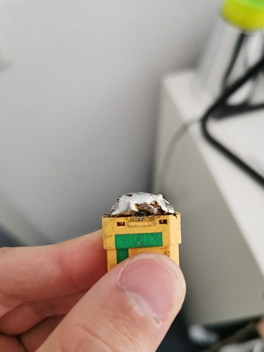

Is it bad to not use wire at all?
For me it was easier to just solder a bridge between the tips with solder only (but a fuckton of it, it’s thiiiicc). Is this dangerous or bad?
Not pretty, I know
What do you hold onto when pulling it out?
This was also my question haha - I assumed some sort of 3d printed piece he glues on?
Yes, I did pull it off to show how the soldering looks, 3d printed stuff. Have this T shaped piece that the loop key slides in. And my enclosure will have a mount for the other xt90.
I assumed he didn’t think that far ahead.
I stand corrected.
@BillGordon
So, is it safe to use only solder? Was easier for me, but is it bad?
It has the same thickness a wire would have, probably little higher resistance, but is it important to have wire?
I would put it more as not ideal than wrong. You bridged the connections, which is the intent.
It’s fine as long as you have a way to unplug it
