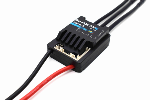

I’ve used these and found them to be quite good, but a decent bit of soldering is required to make them work with common sensor wires and likely your remote
Fortunately, makerx includes all the cables you need
