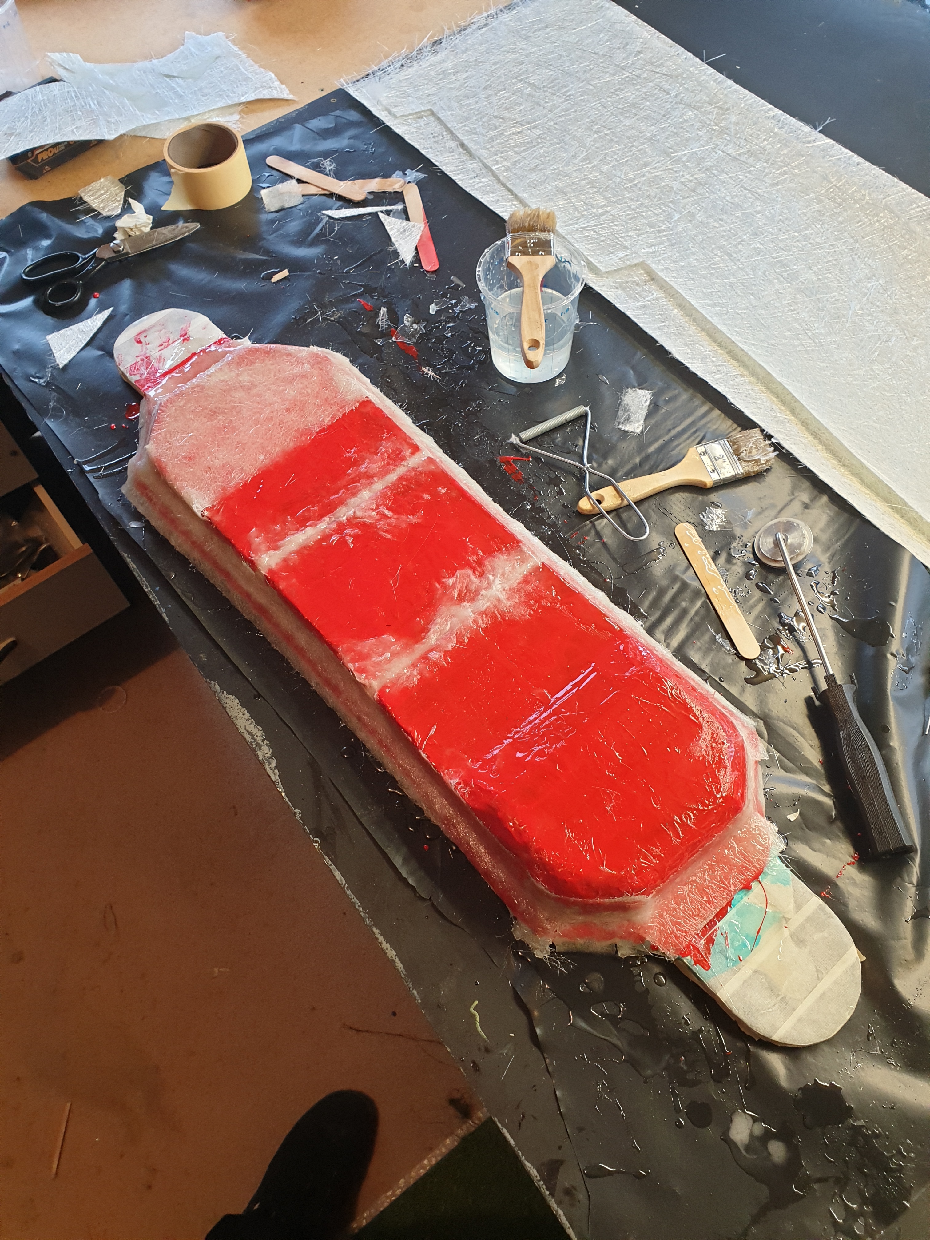

Finally I was ready to start on the actual mold! I decided to use a gelcoat as my first coat, to make finishing the mold a little easier. To the best of my knowledge, all gelcoats are polyester based. I read in a few places that you can’t successfully put polyester gelcoat over epoxy resin. But I couldn’t find any information about using polyester gelcoat in an epoxy resin layup. So I used it and it worked fine.
Edit: I have had further advice that it is not a good practice as there is virtually no chemical bond between the two elements.
Once the gelcoat is applied, it needs a couple of hours to tack off before any glass or resin can be applied. You want the gelcoat to be hardened but still tacky when you start applying glass.
I filled up the segment gaps with fibreglass fluff and resin. You can buy this, but I didn’t have any so I finely chopped a bunch of scraps. I used a paddle pop stick to jam it in there and push the resin in too.
I was using quite heavy weight chop strand matting for my enclosure and it was difficult to get it to conform to the corners, so I cut it into sections to make life easier.
The laying of the glass and resin was definitely the hardest part of this whole process. You need to make sure that all of the glass is thoroughly wetted with resin, and also that there are no air bubbles. I ended up with a couple of bubbles in mine because I was in a rush and it was super painful to fix later. You can see in the photos above that some of the glass strands are still white and not wet, this happened because the resin I was using had started to catalyze and went off before I could thoroughly wet the glass.
My advice is to make your resin in small batches, to avoid losing large amounts of resin because you took too long! I have been told that if the resin is in a dense environment like a cup, it will catalyze faster than if it is spread out like on a plate.
Edit: Apparently the reason is on a molecular level, molecules are further apart on a plate or large flat surface. Worked well for me.
At this stage, i thought I had completely fucked my mold and I needed to go out, so I didn’t go any further. But for you guys, the advice would be to let that layer tack off a little and then apply another layer of resin and glass.
Once cured, you need to use a plastic or timber wedge to try and separate the mold from the buck. I couldn’t get a wedge in anywhere so I flexed the deck. This did a great job of separating the deck from everything, but the bucks were now stuck in the mold.
I used little wedges and I put a screw into the bucks so I had something to grab and pull on. It worked very well.
