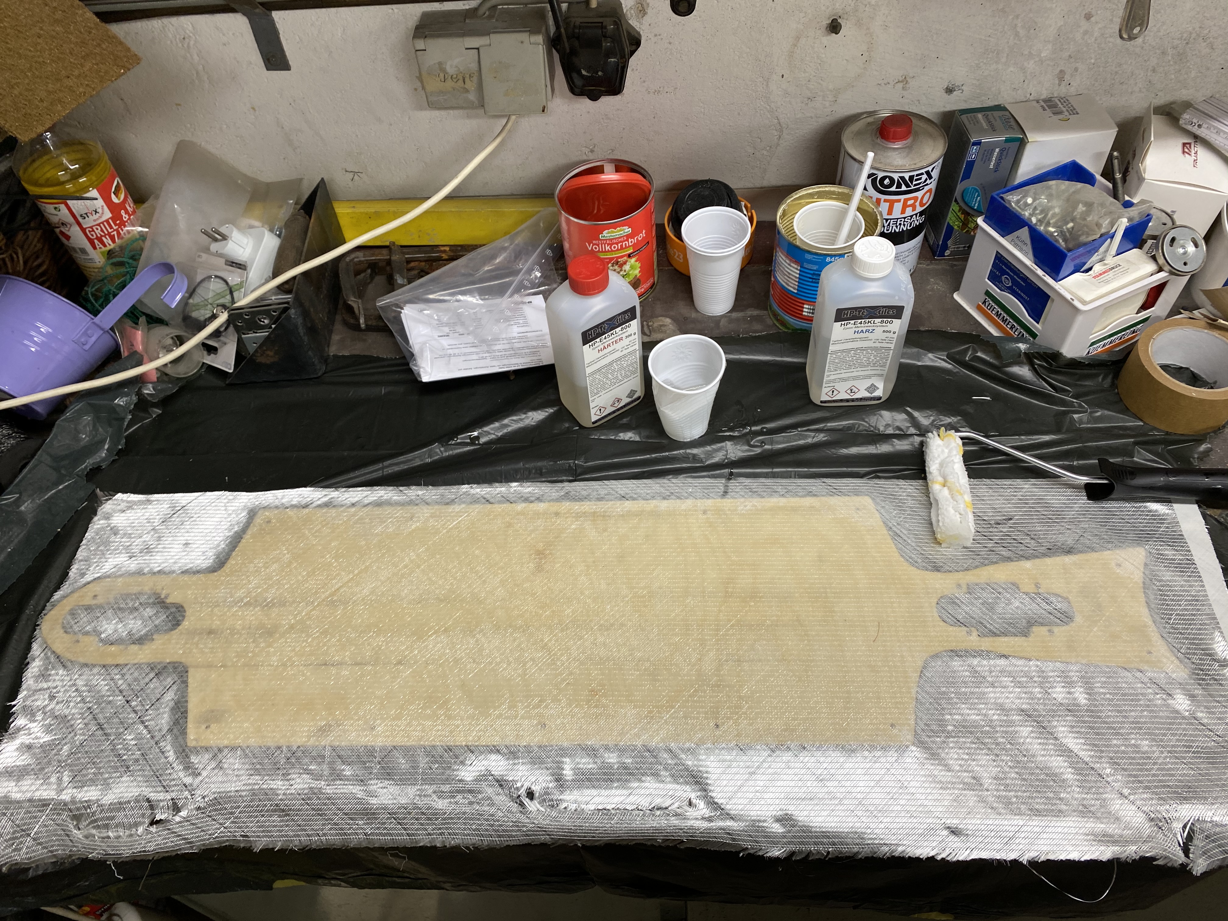

I wanted to have a slim board with all the electronics integrated inside, in a slightly unusual shape made of wood. Spoiler: the wood didn’t work out.
Milling it out of one piece of beautiful wood exceeded my DIY possibilities (and purse) by far. So the compromise was a sandwich board made of 3 layers:
Center: watercut aluminium frame (perfect rough template for cutting everything else in shape with DIY tools, screwing things together and way cheaper and more stable than cnc milled exotic wood)
Top: birch multiplex (9mm/0,354inch) reinforced with 3 fibreglass layers with milled air channels
Bottom: fibreglass box for the necessary cavity directly laminated onto the aluminium frame, covered by a foil in wooden design:
Inspired by @glyphiks HowTo Fibreglass thread (Link) and watching some youtube guys I felt ready to this!
I ordered material for 2 layers 320gr biaxial and 1 layer 440gr unidirectional glass fibre material for strengthening the birch plank which got screwed and glued to the aluminium frame. The lid was simply cut out and is fixed/removed with 4 countersunk screws to the aluminium frame
For the integrated cavity in the mould I used simple wooden boards as placeholder
I read some interesting tutorials for building custom loudspeaker cases where they stretch flexy cloth over wooden boxes in order to get a seamless design. In valleys one would keep the cloth down with stapler. I used double sided tape (which didn’t work out completely because the epoxy slightly removed it here and there, so I held it down with wheight in the end:
After curing I had a nice and stable shape to apply 4 layers of glass fibre Satin weave cloth laminate
Without vacuum I expected quite some bubbles underneath the top PE foil and I wasn’t disappointed
Thus, I did, what every glass fibre enclosure DIY builder has to do: sanding sanding sanding
In the end, everything was wrapped in foil (furniture foil, here “dark apple birch chocolate wood “ 5€ ). So cheap but so much of a difference
In the end the deck weighs 3,5kg (7,7lbs) with its size of (94x22x2,1-3,5 cm / 37x8,7x0,82-1,4 inch) and has no flex (toilet paper for scale).

• Sanding sanding sanding: next time I would pay more attention to the final layer (tear-off fabric fiberglass or vacuum or just more patience with removing air under the plastic foil). It was several hours sanding by hand and machine till it was somewhat acceptable smooth.
• After the very first ride the bottom fibre glass came off at one small spot. I blame the combination of double-sided tape and epoxy: the epoxy seemed to loosen the tape, yet there was no or not enough epoxy where the tape (too much tape / too little epoxy on small flange) was which lead to poor adhesion. The rest of the connection seemed solid. Nevertheless, I was too scared that the bottom enclosure part might peel off completely over time at top speed/vibrations destroying me and all the precious electronics…so I added some screws (aluminium frame for the win again). Somehow breaks the clean design but safety first!
