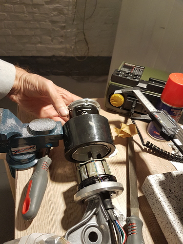

Step 4: Many hours of lathing and milling in my dark cellar (and buying 3D printed parts) followed:
Step 5: Assembly in reality :smiling_face_with_three_hearts::
Step 5: Heart beating test (where I’m currently stuck :sweat_smile: ) and the little beast shivers like it is cold :sob:
First I thought it was this ordinary “cogging” because I tried it unsensored but the second identical motor which I haven’t modified yet runs perfectly.
Conclusion: Something went wrong during my modification :thinking: Thus I need some help troubleshooting:
What could cause this shaking forward / backward moving of a brushless motor?

I fear it might be some inaccuracy between the axis of the rotating part containing the magnets and the axis of the part with the coils…
The next days I will check this

  1. With regard to detection: yes, it beeps once and after that it trys to turn on throttle input.
  2. Unfortunately I didn’t test it before modifying it. But it is my third APS motor and the other two identical models (one with similar 100kV, one with 130kV) work perfectly fine on the same ESC.
  3. I had to squeeze the wires through a small groove, maybe I squeezed to much:
  4. Magnets are all fine and haven’t been touched by me.
  5. Bullet connectors are fine.
  6. ESC works with two other motors of APS perfectly fine. So it shouldn’t be an ESC issue.
  7. Misalignment (~0,1-0,2mm) could be possible.
  8. Manually it turns ok, just the way a brushless turns by hand. If you give it a spin by hand, it makes a few turns till stop without noise.

Does it work, if you start it by hand and than you give throttle? Since you are saying you have the unsensored version of the ESC, it seems very likely to me that it will only work this way.
:ok_hand::ok_hand:
Oh, okay. Than I have no idea.
Getting the new winding on isn’t hard and once you know what to do it should take like 15 min, but getting it off can suck.
Unsensored controllers, specially ones derived from RC airplane designs like that one, have issues with inertia.
Since you significantly increased the spinning mass by adding a tire, you’ve also significantly increased the moment of inertia, which can make controllers like that simply fail to start.
I second the idea of trying to give it a spin by hand to get it moving before applying throttle.
If that doesn’t work, I highly recommend upgrading to a VESC or derivative thereof.
