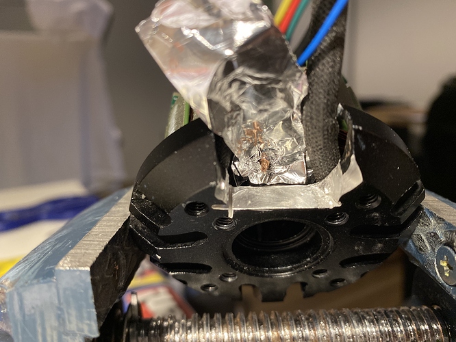

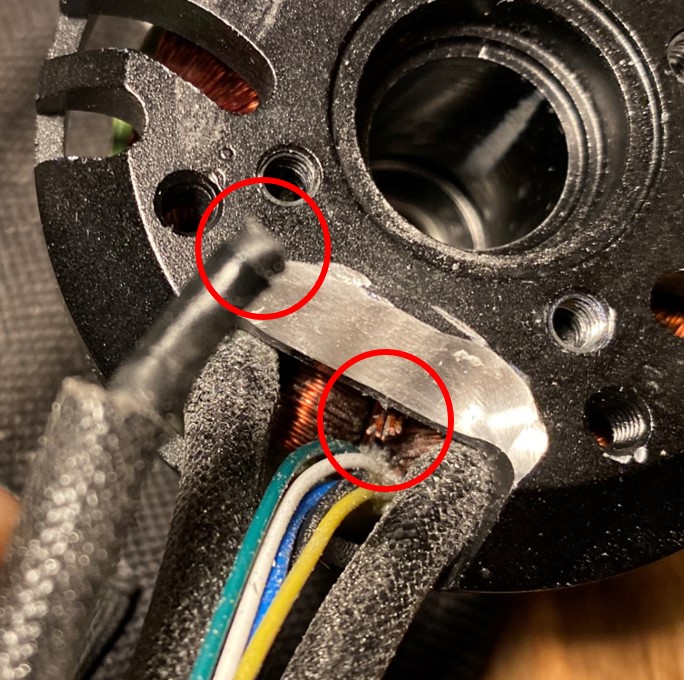

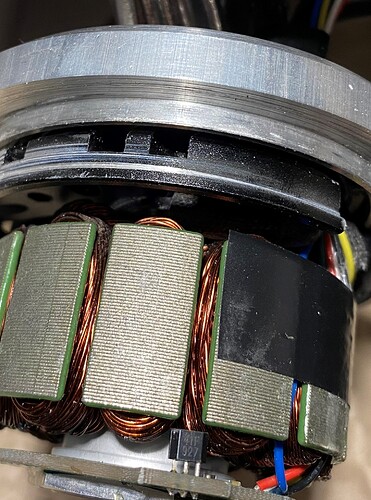

I’m no electrician, but I think there is something wrong with the wire, but see for yourself:
Somehow I didn’t see this underneath the isolation and it was tight enough to hold it in place…
–> Thanks for all your efforts and support!!!
Is that a phase wire totally broken away from the windings?
Open and try soldering it back on, replace it etc.
if you can get to that wire stack with a probe without touching anything else and make decent contact, you could alligator clip to the probe and test it. At low speed and no resistance, there should be minimal current and it’ll move
When you mentioned that it “passed detection” what did you mean?
We are obviously referring to using the VESC tool software and a proper VESC to run FOC/motor detection which will spin the motors as it detects electrical parameters.
If it spins up smoothly during detection, you’re off to a good start. That’s obviously after we fix the broken wire.
Yes it is. I like your idea with the alligator clip testing but unfortunately I can’t assemble it with a alligator clip because of too little space. In an unassembled it cannot spin.
But I will try to peel that wire end out of the motor in order to have some space for soldering decently.
I think there was a misunderstanding about the detection. I tested it on an ordinary ESC where it gave the same beeps as the other working motor gave for reference. This I interpreted as a faultless detection.
no no, clip the alligator clip to a solid piece of wire or some other conductive probe and just stick it to it.
Granted, there’s clearly a busted wire and if nothings broken, its probably gonna work beautifully. You can test it with a probe to get a sense of where you might be headed. But its hardly conclusive. Just something you cant do like you said, once its apart
if you can open up the motor(removing the top end there in the picture) and get maybe 1-2cm of length on the broken phase. Then its fixable. It’s going to be tricky but its definatly doable.
Worse case, you will have to unwound it abit to get some length to repair it.
Only problem i see is that your undamaged phases will practically be longer than the broken one, since all the wires are individually insulated by a coating, to repair it you need to remove the coating with some acid or sand it of very carefully. Then solder backsome wire to get the length you need to reach back to the ESC. This effectively reduces the length of the separated conductors however, making the “new” part of the conductor an extension of the path from the ESCs PCB essentially.
Not sure If I’m making any sense to you :man_shrugging:
It probably wont pose much of a problem since the inductance is in the coils not in the straight part of the wire. But there is an upside to rewinding it if you wish to have it identical to the others.
The solderjoint on your repair will definatly be more prone to wear than the more flexible unbroken ones as well.
It makes sense to me. But as it is in front of the coils and only few Millimeters I hope it won’t have any effect.
Unfortunately I won’t be home till Sunday to work on this :angry:
After some fumbling around with the preparations/precautions and not too beautiful soldering…
I managed to revive it :partying_face:
At the weekend I’ll search for the source of these vibration(noises) :thinking:

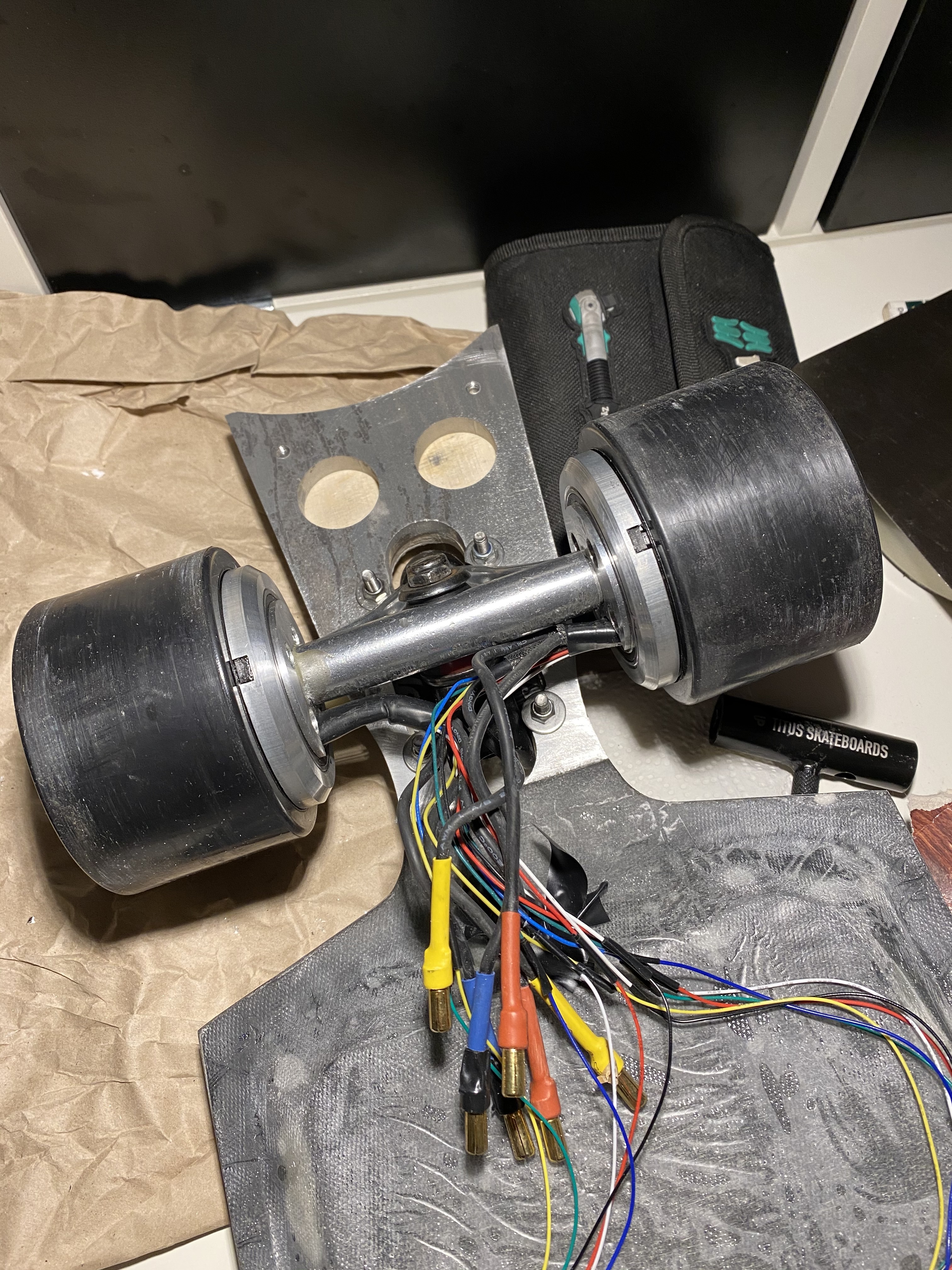

Finally I had some time to finish the second motor, board itself and electric stuff:
And actually it ran nice and smooth:

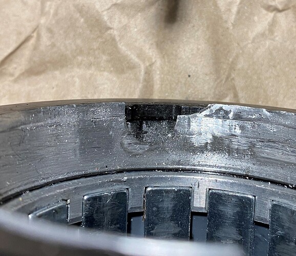

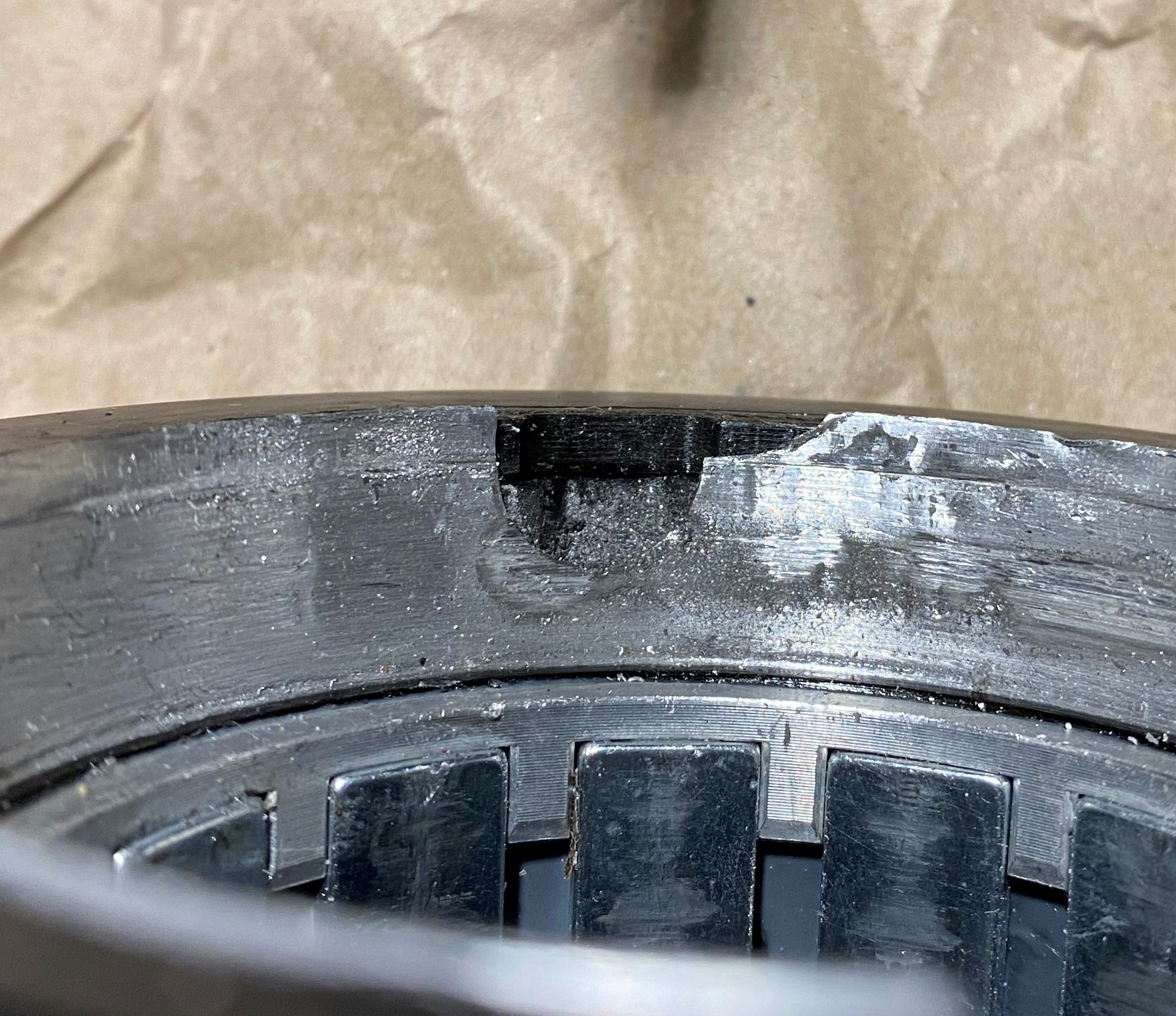

After a short ride (before snow fell, the first time this year…), one motor gave some kind of creepy grinding sounds. So I stopped testing and carried Frankensteins monster home :frowning:
Between the aluminium sleeve support and the stator of the motor had gathered some aluminium powder… grinding traces weren’t hard to find :sweat_smile:
Explanation:

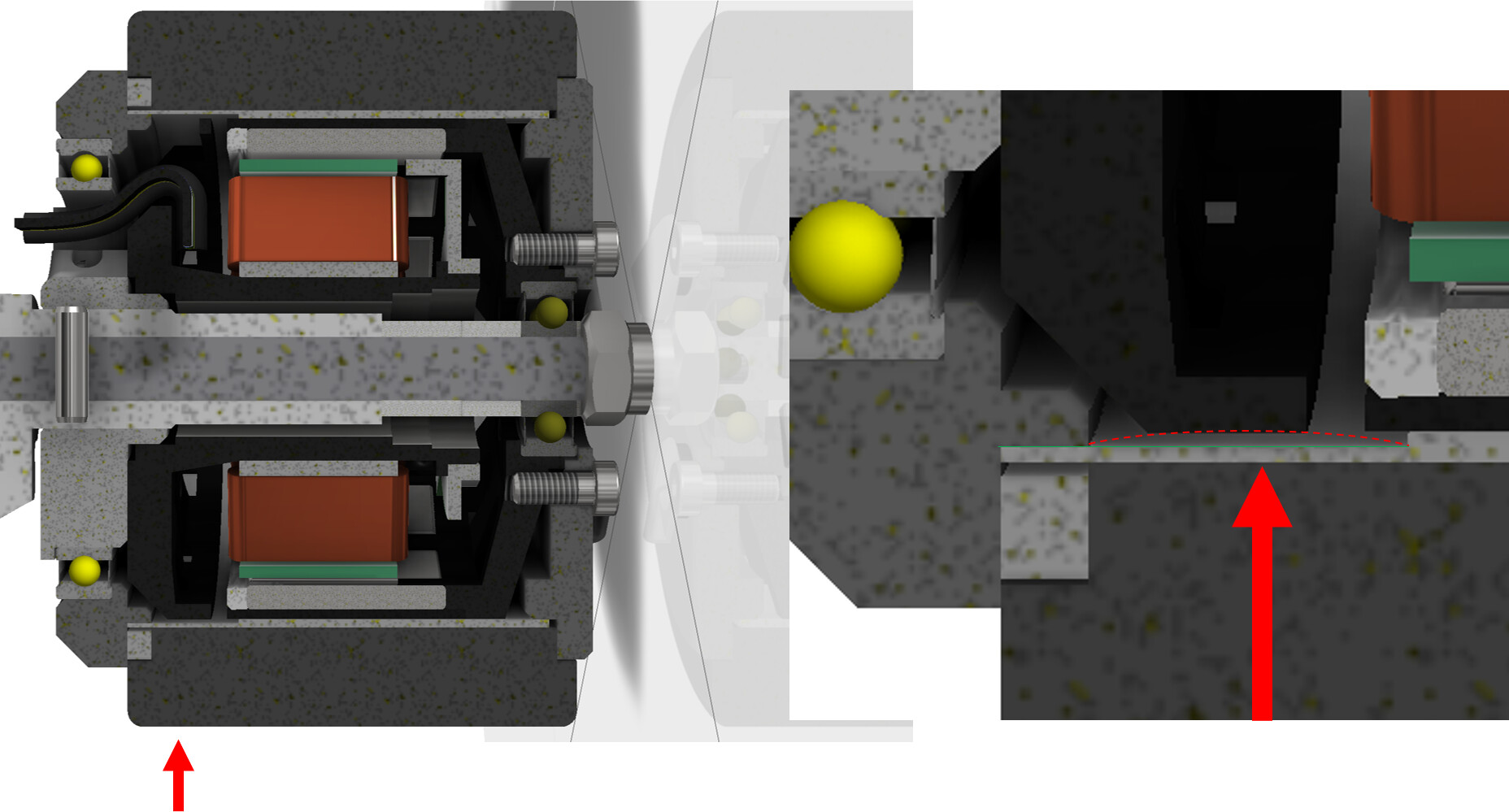

The thinnest part of the aluminium tube (as sleeve support) is 0,5mm thick having a gap of 0,5mm radial to the stator. I knew that this would be the Achilles’ heel of my design but I expected the hard PU and aluminium to not bend… and it didn’t…at least on one side…but on the other side it did :laughing:
Anyways, I always wanted to cast my own hub sleeves where I can have a thicker support and more space for an aluminium tube :sunglasses:
