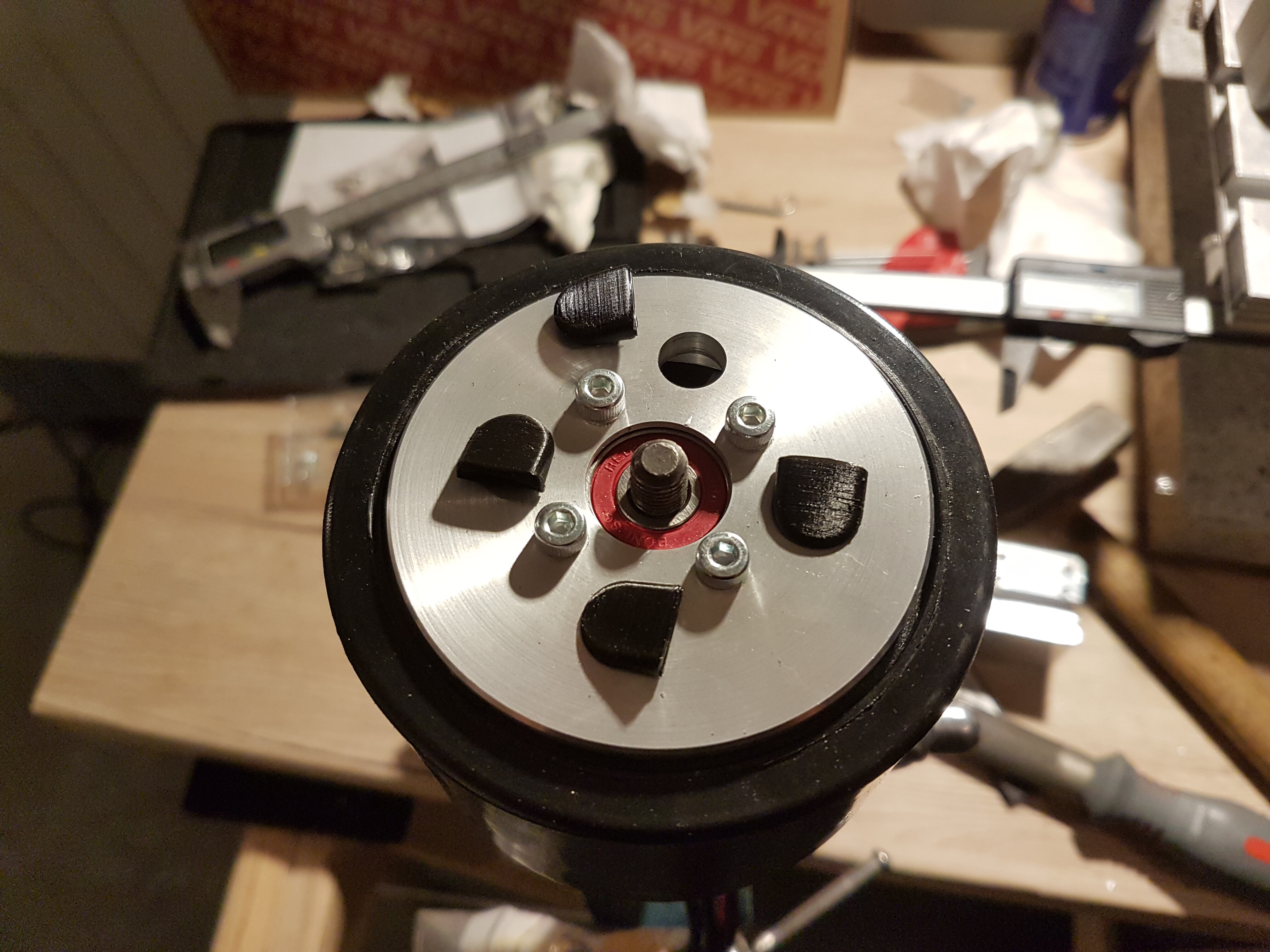

At the end after some km with 40km/h motors reached 80 degrees Celsius but no sign of defects so far :crossed_fingers:
heat and hubmotors, the saga continues
Will there ever be a propper solution to hubmotor heat problem, like forced air cooling with some sortof metal fins. From my understanding raptors heatpipes werent enough to remove all the heat.
Yeah and I’m not surprised. Read numerous posts about it and I believe the physics :nerd_face:
I pushed it quite hard that day and it is 8S with up to 40A allowed for each motor. I provoked it to see how bad it would get.
But I didn’t design it for long distance races at 40-50km/h. Just need it for short sprints :cowboy_hat_face:
Nevertheless I printed some rudimentary air scoops to maybe improve ventilation. I will try to evaluate if they might have any positive affect on the temperature but I don’t like the look…
The rotor throws the air out with centrifugal force. You want a scoop on the other side and where you have holes add blades inside for the air to be thrown out of like a fan. I did the same as you once.
I see ur drawing snd the metal plate u have with the scoops… if u milled slits going from center to edge would be ideal for throwing air out, but then you need a hole on the other side and will be sucking up all kinds of ferromagnetic debris.
