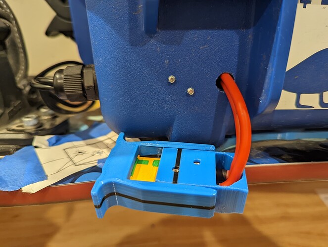

Alright ladies and germs, here we go. I think this project is far enough along to push it out into the wild.
In action:
The Goal
is a new loop key design that is:
  • easily 3D printable
  • captured / self-contained / no losing keys or carrying another fob
  • compact & small footprint
  • secure mounting
  • locks out when powered down
  • slick looking
  • reliable
To that end, I present the Captured Loop Key V5.

  • Ring Handle version: 78mm L x 33mm W x 17mm H
  • T-Handle version: 52mm L x 44mm W x 17mm H
  • Mounting Hardware: requires qty 2 x M3 hex nuts, qty 2 x 8 or 10 mm long M3 fasteners (depending on enclosure wall thickness)
  • Epoxy strongly recommended to lock the XT90 connectors into their housings. But DON’T COVER THE NUTS!

Notes:
  • The Ring Handle version can take any normal loopkey. It’s get extra depth to account for an off the self (unmodified) XT90 with a section of 12awg connecting the pins.
  • The T-Handle version is designed to be as short and compact as possible. You have 4mm total height for the pins and wire on the end of the XT90 female. This means the pins need to be dremeled down.
Gather your materials. The T-Handle version requires the super low clearance loop key.
Don’t use this much epoxy. If you do, it squirts out through the actual pins of the XT90 and then you have to clean it out with q-tips. You don’t need much.
Press connector into hole, with some force. It will snap in solidly.
Build the other half
Make sure you don’t use too much heat shrink or it’ll be tough to feed and bend the wires
Final assembly
MAS IMPORTANTE: press the nuts in with a small pair of pliers before inserting the connector
Wires first. Add a small amount of epoxy here to the outside of the connector.
Push the slider onto the mount and it should snap satisfyingly into place
Print the diagram, cut out the 1:1 scale view, and tape to your chosen location.
Drill your holes (9mm or 3/8" bit is good for 2x 12awg wires)
Install fasteners. Don’t forget the blue loctite.
Mount
Close
Silicone the hole if you don’t like water
Done!
Enjoy the satisfying snap.

  • The lock-out (holding power off) detent is too weak. I had my board vertical and the loopkey slide partially closed. Very confusing behavior until I figured it out. Hopefully this didn’t/won’t cause any damage, but something I’m going to resolve asap.
  • The 2 screw offset mounting design is surprisingly strong. I was a bit worried it would rip out eventually, but it’s solid as a rock. Confidence inspiring. Could easily move to 3 screws and/or bump up to M4 screws if necessary.
