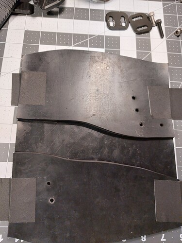

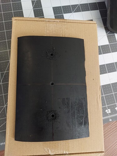

Footpads:
I wanted to do something a little more elegant (and serviceable) than just running the wires below the grip tape so I decided to make them out of sheets of 3/16" and 1/16" thick rubber.
Really like the blue tape to cut out method, works flawlessly:
I measured out a line on both sides of the deck that was 50mm from the center holes for mounting the top box to give myself a point of reference, this way if anything could be flipped and used on the other side I would.
For the side with wires going under I wanted to have a layer that bridged over them for just a little bit more protection, that is what I used the 1/16" rubber for. I just laid the wires over the top and taped them on either end, then just traced them with a sharpie to get the cable channel outline.
