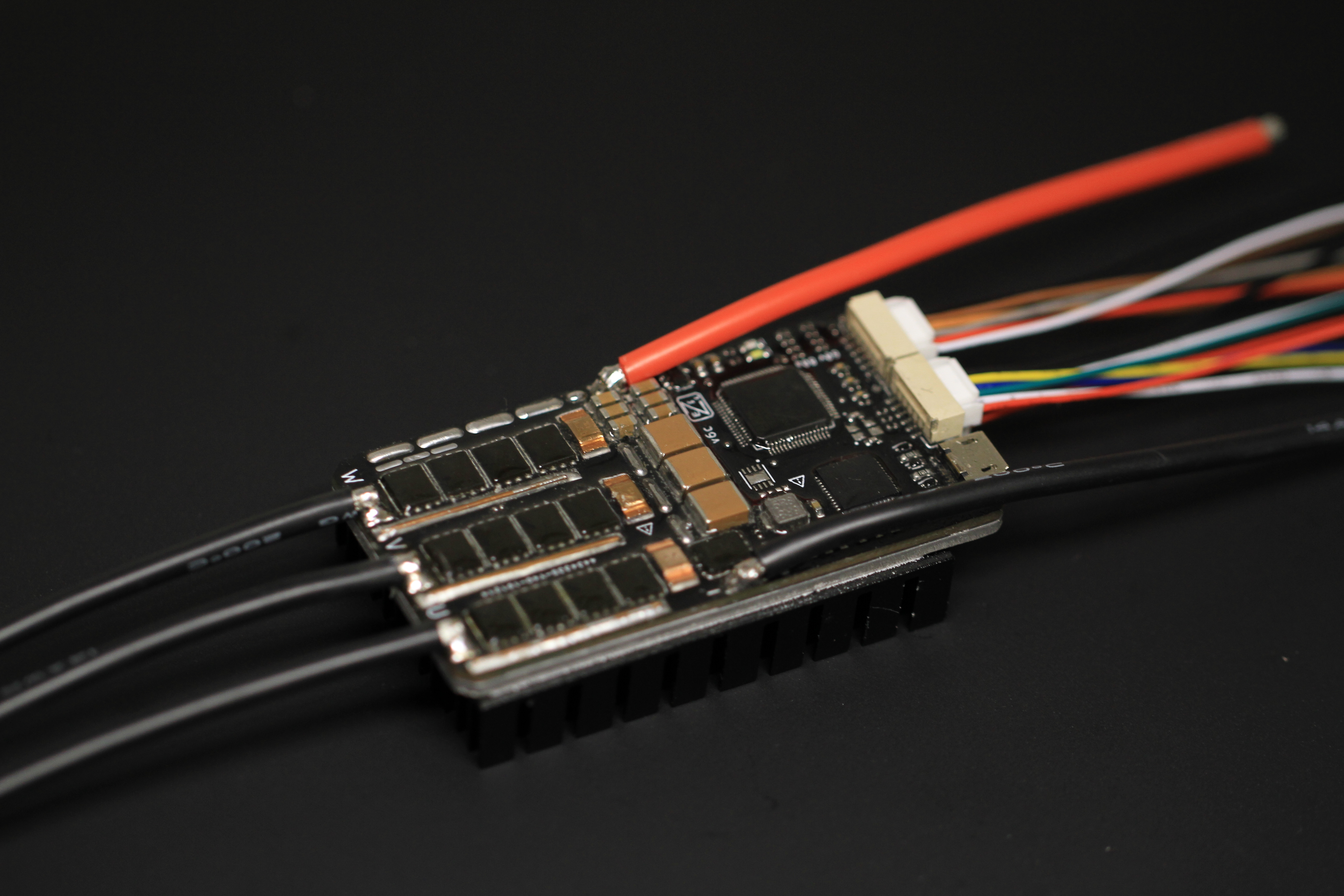

ZESC v6c vesc variant
ZESC V6C based on vesc6
Technical details:
Input: 12-60v (3-13s)
Output: 60a (phase current in FOC) for continuous, 120a for 30 seconds, 1000w for continuous (tested)
IO ports: adc1, adc2, uart, ppm, iic
Highlights:
twelve 0.0014Ohm 60v 100a Mosfets
on-board anti spark switch
drv8323 intelligent driver
all capacitors are solid capacitors
3 shunt resistors
super compact design, small volume and high power density
gh1.25 connector with lock
high quality heatsink

good point! actually this is just a working prototype. I could add a C port in the next version.

Does that mean just 20A continuous battery amps ?
This design is wonderfully thin without the heatsink.
Suggestion: use a smaller copper heatsink with bigger mass but much thinner profile.
If you can get it down to 10-13mm, one could stack two of these and they would be similar height to the batteries → ideal for a cramming a 4WD in a board with integrated enclosure.
For battery current, when I did the test, it was around 40v 20-25a. Really not sure its potential, because I did not find a larger motor to test it.
For the heatsink, you could just customize by yourself. There’ s no component on the other side of the pcb. you could even attach a water block on it.
I like that. In that case, I would recommend removing the connector on the other side making sure it’s flat. Like that it can be directly glued onto a heatsink (such as on some enclosures)

These are 1.25mm pitch? Nonstandard, So hard to crimp, and takes only very thin easy to break wire?

Design looks thought through. How is it managin without any electrolytics tho, how much cap could you fit in just the ceramics?
Good that you did a contineuos 1kw test. But…you did test 13S that you claim? Or are you just refering to maxvalues and thinking its cool?

Nice compact design, I see there is some space left for CAN header. Maybe you can consider adding it :slight_smile:

Pardon the silly question, but why is the heatsink on the opposite side from the FETs?
