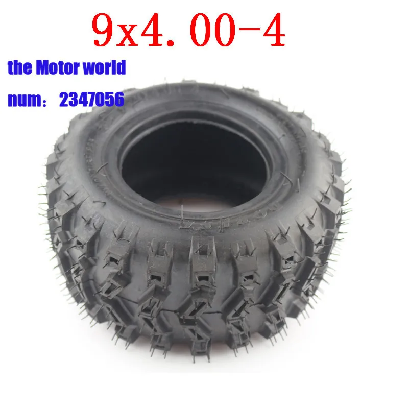

Ask you shall receive, but it needs to be even wider
At that point let’s just use go-kart tires
Dimentions x the smallest go-kart tires to the right?
Is that even possible, Pedro?
How about inside bearing distance? Is possible to keep them under same usable axle lenghts?
What would be the minimum usable axle required x for this installation? TB axle is 47mm, Evolve SC is 32mm; theres even a hub bearing adapter from Board Bumpers for the Trampa superstar x that short Evolve SC axle. There are a dozen more brands in the middle (??)
