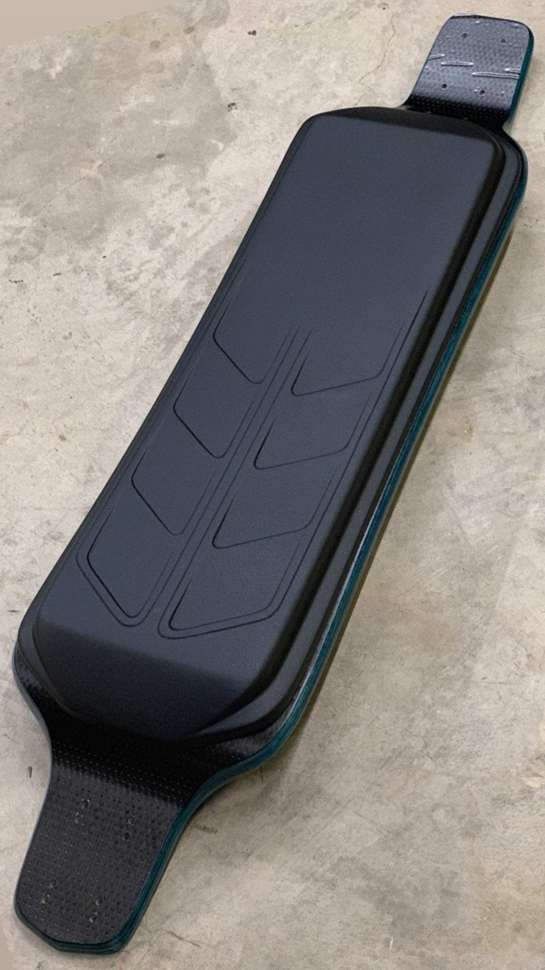

Eboosted Enclosure
Need I say anything about this gorgeous enclosure. It arrived the same day as the deck and fit like a glove. Alan’s method of installation works great… just take your time to drill holes carefully and perpendicular to the board surface. I used a ridiculous amount of rubber bands along with some double sided tape prior to drilling holes. Not only did this keep the enclosure in place, it helped to pull it into alignment end to end.

Behold: The Eskate Enterprise
33 MPH… no problem. This board is extremely stable and makes my 10S boards feel like I’m flintstoning again. :stuck_out_tongue_winking_eye: @eBoosted… thank you again for such an excellent enclosure and extremely helpful advice prior to the build!
