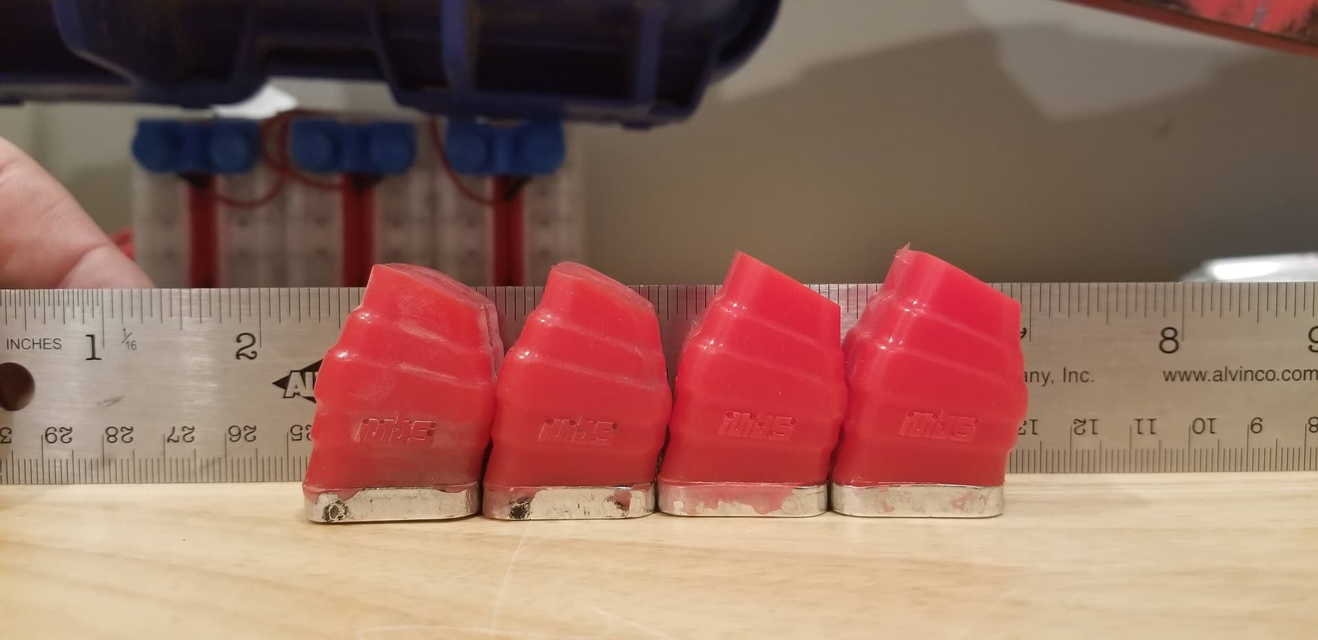

So I did all of these:
And it was a night/day difference.

  1. New Shock Blocks
The old reds I had on there were noticeable shorter & fatter than the new ones. The oranges less so, but still. Replaced all four.
Wild.
I love the bottom graphic of the Haero Bro. We don’t get to see it enough :slight_smile:
New blocks! Still red rear, orange front. Gave them all 1-2mm of preload for good measure, with loctite on the bolts, and took it for a spin. Rides noticeable more stable! Much less tightrope-walking at high 20s and low 30s (mph). Big fan of these changes. And with bindings, I bet if I threw myself over hard enough, I could do a full 180 in one lane of the road. 1.5 lanes is relatively easy.

It’s crazy how those shock blocks shrunk like that! I was expecting them to spring back.
