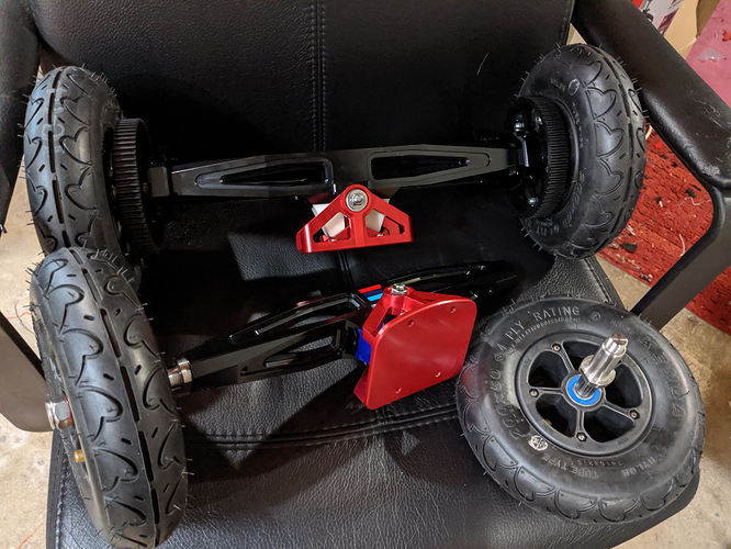

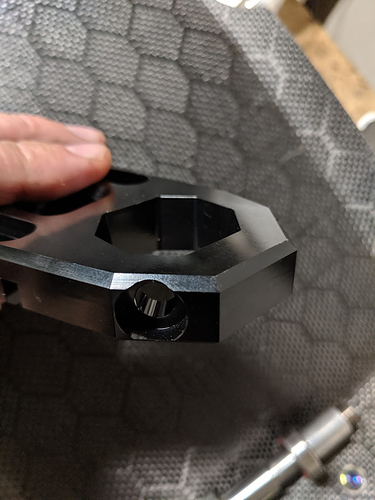

  • HyperTrucks - These are a game changer for me. In my mind they are clearly built for street over AT/off road, simply due to their wide stance & design intent focused on higher speed carving. I am still running the softest bushings that came with it (@Arch thinks this is silly), once broken in these have become the very lively - coming from heavy use of spring trucks its nice to still get that with bushing blocks. They are far more responsive than yellow shockblocks on MBS. At high speeds, these trucks are the most stable and give me higher rider confidence than any other channel truck I’ve ridden. I’ve maxed out at 43mph on LoveChild going downhill and stability was not holding me back at any point.

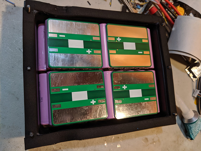

  • Excessive Silicone Potting of the batteries/internals - So far it’s rock solid, and not a thing has come loose. The board is dead silent from vibration noise; not a single noise from it aside from the tires & motors. Thanks @Sender for sending me off the deep end with this methodology.

Designed some battery PCBs with 2oz copper weight pour:
Yeah girl.
Thicc balance cables. Because.
Literally a pound of silicone in this thing. The battery and enclosure become one using the “Sender Skates Silicone Bukake Battery Building Method” aka SSSBBBM™. Heyo @Sender
