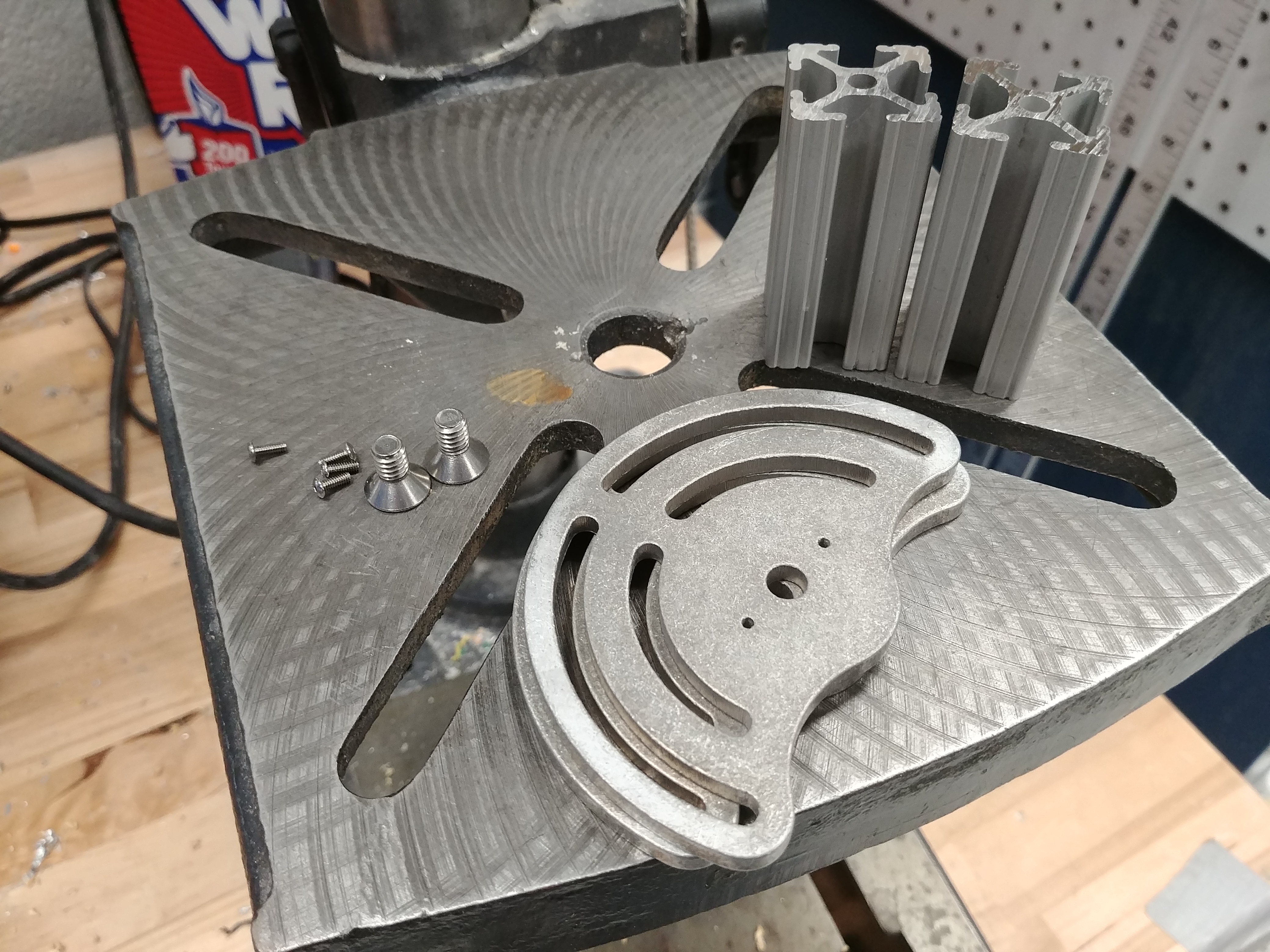

As promised, here’s a little how-to: what to do with the plates and general assembly.
Here I’m using imperial numbering. For metric use M3 instead of #4-40 and M6 instead of 1/4-20, otherwise the process is the same
So, we have 2 plates, 2 8020 profiles, 2 1/4-20 countersunk bolts and 4 4-40 bolts.
  1. Drill the two big holes in such a way that the bolt head will be flush with the bottom of the plate:
  2. Next, do the same for the two small holes, just enough that the heads of the bolts will be flush:
  3. Tap the remainder of the small holes with #4-40 thread:

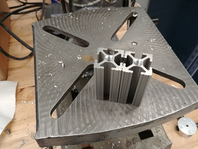

  4. Set the plates aside, take your profiles and tap the center hole with 1/4-20 thread:
  5. Put in the 4-40 bolts, use of loctite is advisable here:
  6. Insert the profiles on the tiny bolts. The fit is tight (on purpose) so light hammering is necessary (it’s not bad as it sounds) with the handle:
  7. Put in the central bolts 1/4-20, use loctite:
  8. The hard part is over, now just slide in the 3d printed parts:
I was using the 3d printed cap from @mmaner. To secure it I tapped the other side of the profiles and used plastic 1/4-20 bolts. Way overkill of course, but clean.
Generally, by tapping the other side of the profiles you create a very sturdy mount for anything, like cameras and stuff.
I’m here to answer any questions.
Enjoy,
Dani
