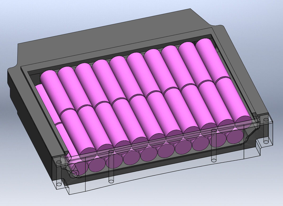

These are molicell P42a cells against the case profile. Looks possible to fit that with a bit of effort
Issue being that is 19 cells, not 20. So you could do 19S2P… OR
you could do this stupid shit!
yeah. That would be pretty solid.
Looks like you have to stick with 18650 then. Those don’t fit, not with fishpaper and what you need to do it right.
What amount of clearance between cells is required?
I think fishpaper is 0.25mm so one of those between the cells and one around the whole thing, and I think Molicel 21700 might be about 0.3mm (or 0.7? I forgot) bigger than 21mm.
And then polyimide tape…

Someone asked me to check the fit of 18S2P 21700 in the stock XR case as they thought it might work.
They were right it could be possible, but only with 21mm cells or less without modifying the lid and spacing the footpad.
There’s a guy on Facebook in the Onewheel Vesc Builders group that is working on an injection molded battery box that will hold 19S2P 21700, are you aware of that? Might save us all quite a bit of work.
oh well shit I gotta see that!
In that last pic I posted I was not taking advantage of the lid space so 21700 cells can actually fit like in
In the stock XR battery case
Only issue being it is too long overall, so there would need to be some mods to the case to make this work.
