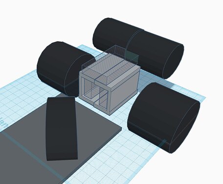

There’s no convenient spot to mount them like the rear, and the belly pan isn’t large enough.
Before I bought everything for the board, the only idea I had was a 5 minutes tinkercad sketch
I live a couple miles down the road from an Industrial metals supply, so I went there to see what they had that could make this possible.
I found exactly what I wanted, but they only sold it in 10 foot lengths.
I ended up riding home with a 10ft piece of steel.
I 3D printed the profile of the steel channel that I bought, so I could easily cut, drill, and manipulate it to find a shape that would clear the 3-links, without taking up too much deck space.

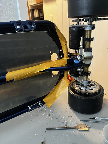

Drilling a 1" holes in the deck to pass cables through.
Doing this was my least favorite part of this whole build, as it had to be above the center tube of the frame. A little too far, and I’d chip my pretty paint.
It’ll work! Still needs to be wired.
