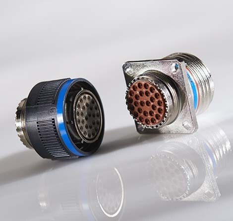

Charging Harness Fix
The charging harness that I have installed (more detail about it) uses DSUB15 connectors to expose all of the balance pins. This setup plus my powerbutton has been blissful- takes more time to pull the board out of it’s bag then turning it on or charging it.
However, some things are obvious in hindsight. There’s a reason that battery balance plugs have plastic housings.
When plugging in one DSUB15 of the “balance harness” (the one with the blue wrap), the other DSUB15’s pins become live. I plug in this second one not straight, they can short on the metal housing of the other connector. Ask me how I know.
Instant spark, and the pin exploded.
New vs old pin, for comparison (xacto for scale):
Still had continuity, so I continued to used it for a couple weeks. Depin the two damaged pins, cut, re-crimp new ones, and re-insert em. Feels good to have that repaired.
The long term solution involves switching to a connector that doesn’t have this issue. I’d love to switch to the aerospace MIL-38999 series connectors we use at my job, just for the meme, but I’m not about to drop hundreds of dollars on two connectors :rofl:
Anyone has suggestions for a good 13+ pin connector that can be panel mounted?

SD20 14 pin
https://www.aliexpress.com/item/4000155877472.html?src=google&aff_fcid=2da3c91358194df4bcb12abce09ddddf-1705057604741-04401-UneMJZVf&aff_fsk=UneMJZVf&aff_platform=aaf&sk=UneMJZVf&aff_trace_key=2da3c91358194df4bcb12abce09ddddf-1705057604741-04401-UneMJZVf&terminal_id=7fe626879a514f608ffb2acbfde19d34&afSmartRedirect=y
Beat me to it
