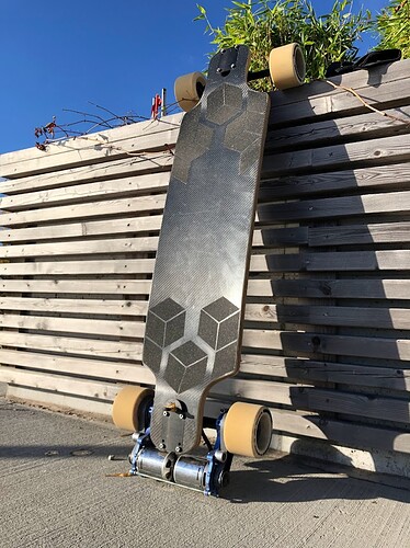

This is a build thread of my latest board. I call it Rat
. I thought I might share it with you all.
Story
My first eskate below was a lot of fun. It was not perfect but it sure put a smile on my face. Sadly it’s parts gave up on me many times.
Last year I built something else. This board is super sweet although it is far from practical. I can’t carry it with one hand, doesn’t turn quick enough and it is a pain to carry up/down my 3 floors.
So that is why I had to build Rat
Rat is a board made by old dirty stuff mostly (hence the name)… yes I don’t think I bought anything for this build
. It will look dirty, because it will be dirty. Snails and land dust does that to a board.

Now it is very close to be finished, Its rideable and range is is good. 27km. The riding comfort could be better though
Now this wheel mod is by far my most satisfying achievement of this build.
I cut a bicycle tire into pieces.
…long enough to encircle the wheel
Contact glue on both wheel and tire strip. Wait 10min then attach. Used tension straps around over night.
yesss
I have not done more than 40km yet on these wheels, but I have been stressing them with carving and there is no sign that these tire strips will come off. The ride is now really smooth, I can’t feel the small annoying stones any more… I like it a lot!
The draw back is the 30% decrease in range I got now
… but still enough for what this board was built for.
I’m very happy to have resurrected a pile of junk in my drawer to something great ![]()
