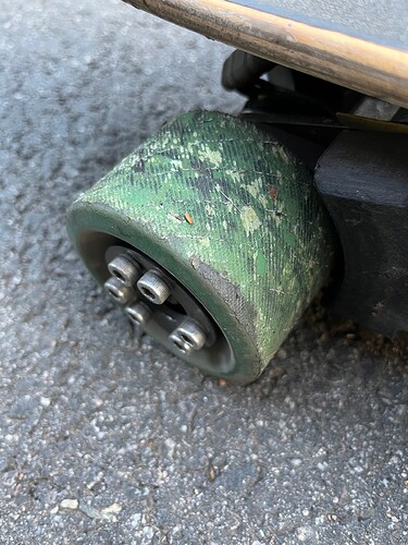

After 1400km the rubber had worn down. One side started making a slight flapping noise so I teared if off since the cushiness was gone anyway.
I don’t recommend this to anyone because…
-the short lifespan of the rubber.
-the effort and precision needed to get it right
-it’s quite dumb
So obviously I made a new set yesterday… :rofl:

If someone were going to do this anyway, what are the gotchas that you’d recommend they watch out for? The things you’d tell yourself before you started, if you could time travel.
That’s untrue. Clouds can go thousands of kilometers.
some can, not most.
@b264
If I could travel back in time I would tell myself this
-Do it for the experiment that it is, not because you think you will invent a new revolutionary eskate wheel.
-range will be 20-30% less
-free rolling will be worse than you think
-it’s a softer ride than you expect.
-Tires on rear wheels will wear out a lot faster than you expect compared to the front wheels
-you think you have cut the pieces in perfect length but they always end up 0,5cm too long when gluing them into place
-If the tire piece is too long, you might get an air bubble somewhere between tire and thane. Rolling on that bubble could force the tire and thane to come apart (I think)
-clean the wheels before glueing.
-avoid overhang since it will interfere with the belt
-those extra 4mm of ground clearance you get from the tires strips will actually help a lot for the belt lifetime if using 83mm wheels.
-easy to rip off I you change your mind
Not sure what to say more. It was a surprisingly somewhat successful experiment. I will see how it works out with the boa100 for my Lamboardhini

Interested if the math for the circumference of the wheel matched up with the tread length you ended up with.
One other thought is maybe if you sanded the wheels to a very very slight concave you could get better range with a little bit less grip, which I would guess you have plenty of.
Since the bike tire strip is not flat, I need to stretch it a bit when rolling the wheel onto it. This always put me in a situation where I have 2-3mm of excess material in the end. It’s really difficult to get a perfect sized strip not needed any modification once glued in place.
Interesting thought… now I may have to try that :nerd_face:
