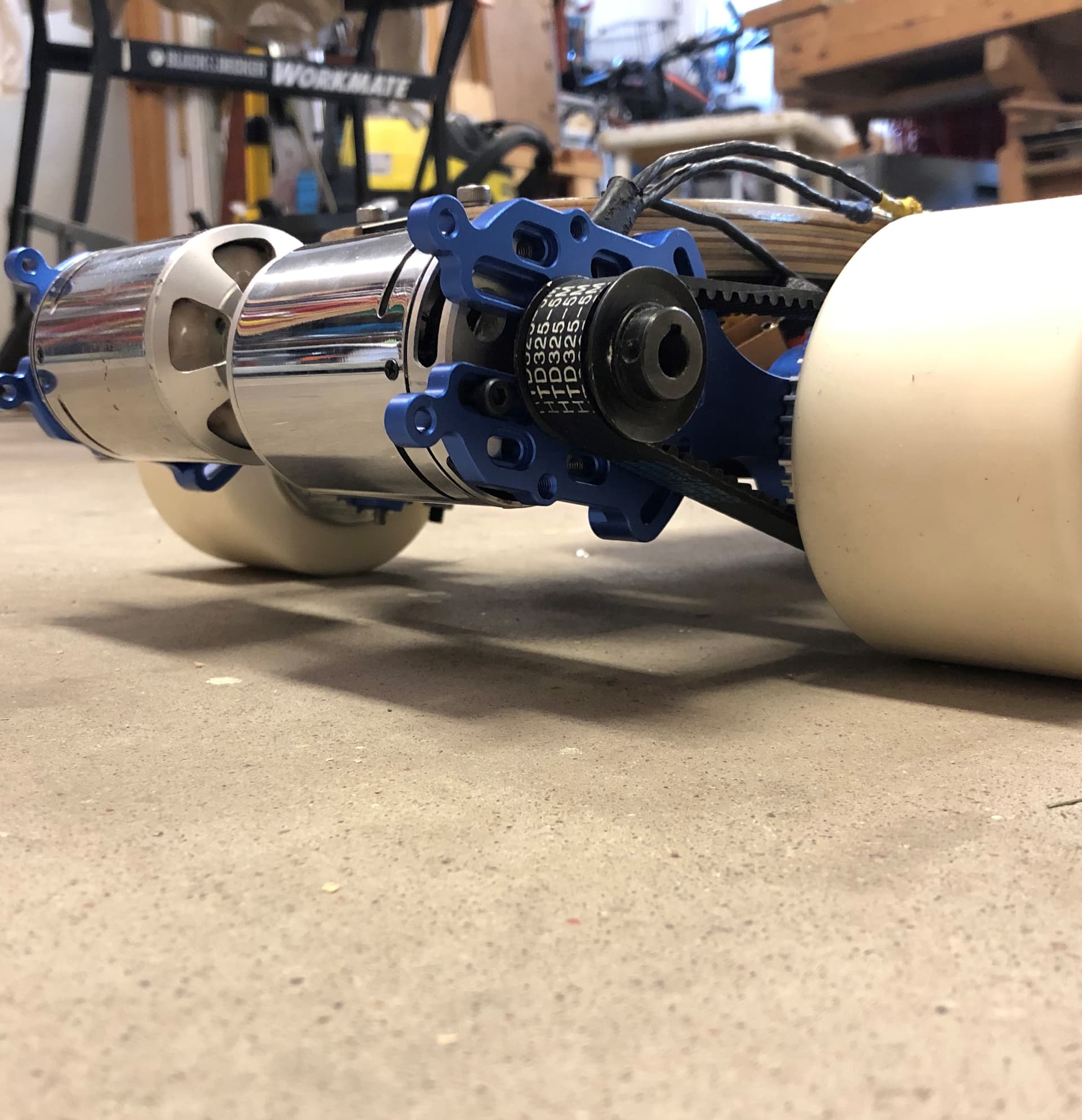

As probably everyone knows by now, these mounts are notorious for not staying in place (at least the long mounts with a heavy motor). Or maybe the ring adapters I got is made of a 50/50 butter/aluminium mix. That set screw is just cutting its way and the motor mounts drop for each crack in the ground I pass.
To prevent this, I measured twice what angle I wanted the mounts to be in and drilled a hole for the set screw.
:confounded:… I should have measured three times instead of two. Well at least the motors are are not going anywhere now.
The cross bars/ torque bars are M3 rods with some nuts and washers. Works great I believe. Very cheap.
The dickyho press fit pulleys were super loose in the boa wheels. I put some shrink tube on them to make them stay in place.
They came with these white plastic thingies. They could not fit the holes in the boa wheels.
I made my own out of cable insulation. This is very Macgyver but at least the pulleys are now centered and zero wobbling exists.

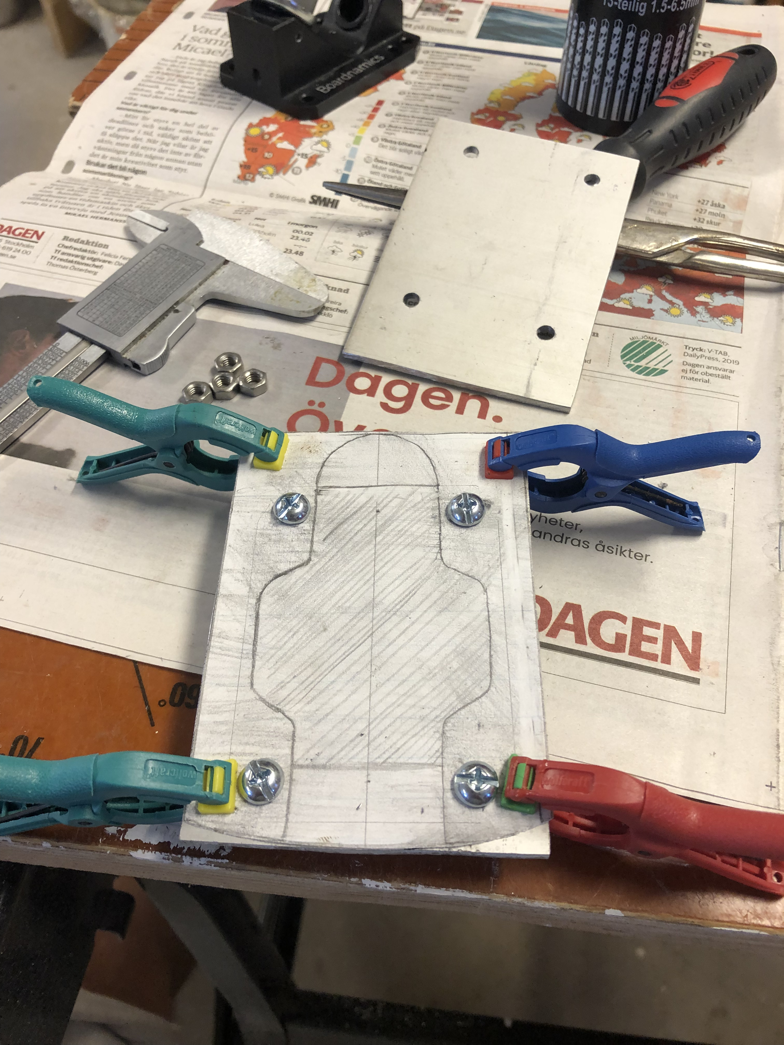

I wanted to build some drop through plates protecting the board so I sketch the outlines on a papper
…then drilled holes in to the plate and lining up my drawing
…I thought the easiest way would be to drill out the gap instead of using a saw.
…oh sweet lord
…but they came out pretty nice in the end
