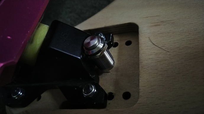

So I got my power switch… It’s the perfect size for where I want it to be except for a certain dimension called HEIGHT. It’s way too long and will interfere with the lid closing if I want it in that recess. I have two, so I’ll cut one in half to see if I can still wire it up.
It’s a nice switch otherwise!
Maybe a 3d printed collar/standoff between the bottom of the deck and the switch so it sits a little higher?
If you can caliper measure, I’d love to make a fender washer in black that it could sit in/on.
Only if your cutting experiment doesn’t work of course :stuck_out_tongue:
