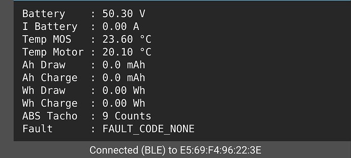

On the VESC app what is abs tacho in RT data?

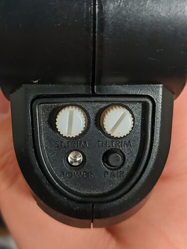

I was horrified today to discover, upon accidentally turning off my remote before my board, that the default behavior of my Mini Remote / DV6 when connection is lost it runs full-speed in reverse.
I am using a ppm connection.
Is there a vESC sitting in my DV6 that will control how it defaults in a lost connection state?
If you mean this by mini remote:
then follow this guide
That is exactly my remote - Thank you!

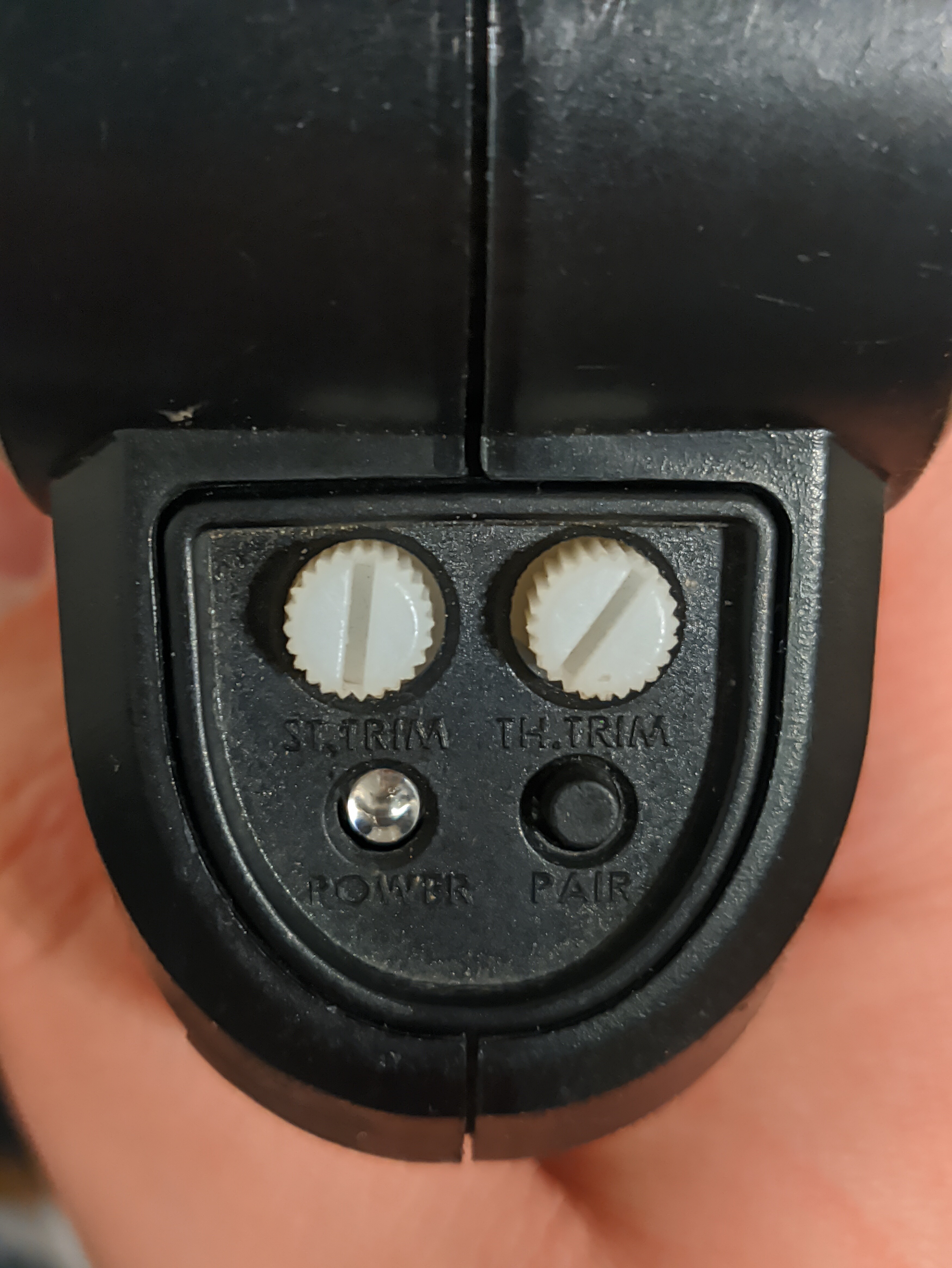

For reference, this is where mine are set to. (Neutral when disconnected)
YMMV, test it before riding!

Well - I suppose it’s possible I am a moron, but I’ve tried it four times following the failsafe instructions to the letter and it still does exactly the same thing. It always binds, but whether or not I turn the white fine tuning knob from 2:00 to 12:00 prior to removing the bind key, or leave it where it is, if I power the controller off before the board, it runs full-speed in reverse. Very frustrating (and very un-safe).
@b264
Mini remote expert. What’s your take?

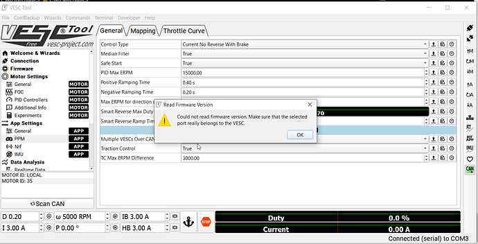

I got some lp20 connectors, but the actual copper connections are kinda loose; is that how they’re supposed to be? Should I like silicone them down or does it not matter?
You shouldn’t need to move the USB cable. I think the problem is not your remote, but that CAN is not set up correctly. Choose an ESC to be the “master” and connect the radio receiver and USB cable to that ESC.
In the software, change “Multiple ESCs Over CAN” to true on the master ESC.
Where do I find setting for multiple ESCs over CAN? (Can fwd has been an issue before so I moved cable)
App Settings > “PPM” > General
Is currently set to true
turned on CAN fwding (it worked) and read app data for other ESC - it was already set to true in both
So, here’s what I get after using CAN fwding for a while:
Only set that to true on the master ESC.
It works for a bit…then suddenly that message
