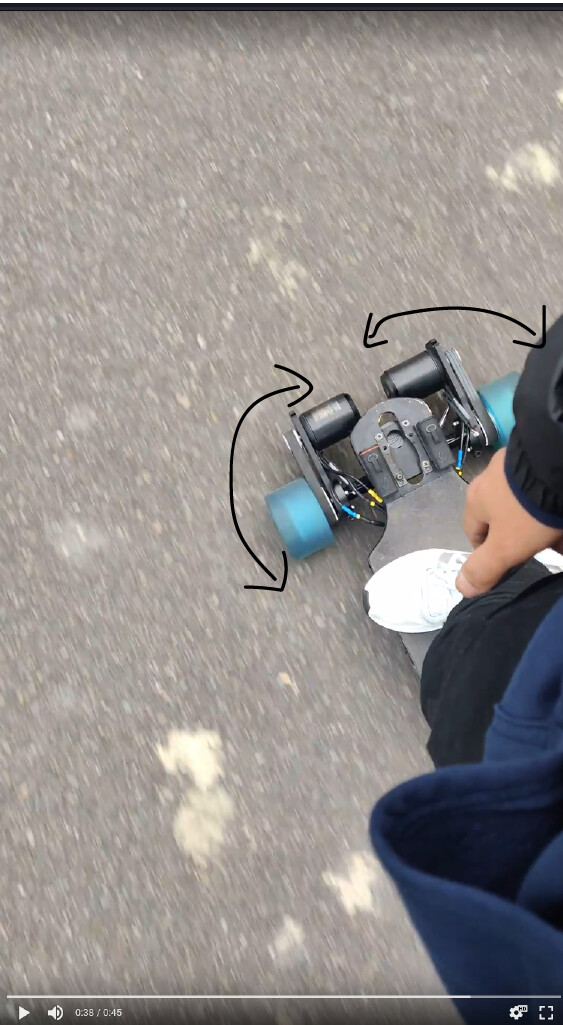

Does anybody know what i need to do in order to fix the wobbles that I’m currently getting whenever i accelerate? I just installed this trucks and motor mounts last night and since then I’ve had this issue. The wobbles get worse with speed but completely stop when i ride in reverse so motors in the front. Video link to show the issue
it’s kind of hard to see from the video, do you mean the trucks wobble left to right kind of like you’re turning but the deck stays level like this?

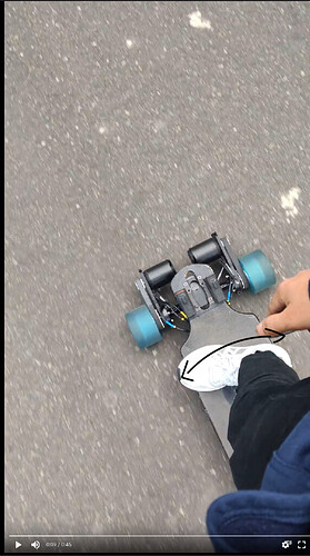

or the trucks stay in place and the deck wobbles like this?
if this makes sense lol
Are your trucks tight enough? It looks as if they’re a bit loose from the kingpin. Either that, or it’s has to do with you mounting those trucks. Usually it’s the mounting that causes it.
I see the drop through deck, but it looks like it’s mounted underneath and has those rubber risers.
Maybe your rear bushings are way looser/softer than the front? That could explain why the wobbles propagate, and why it disappears when you ride it in reverse.
The first one, the trucks move back and forth but the deck continues to go straight or stay in place.
