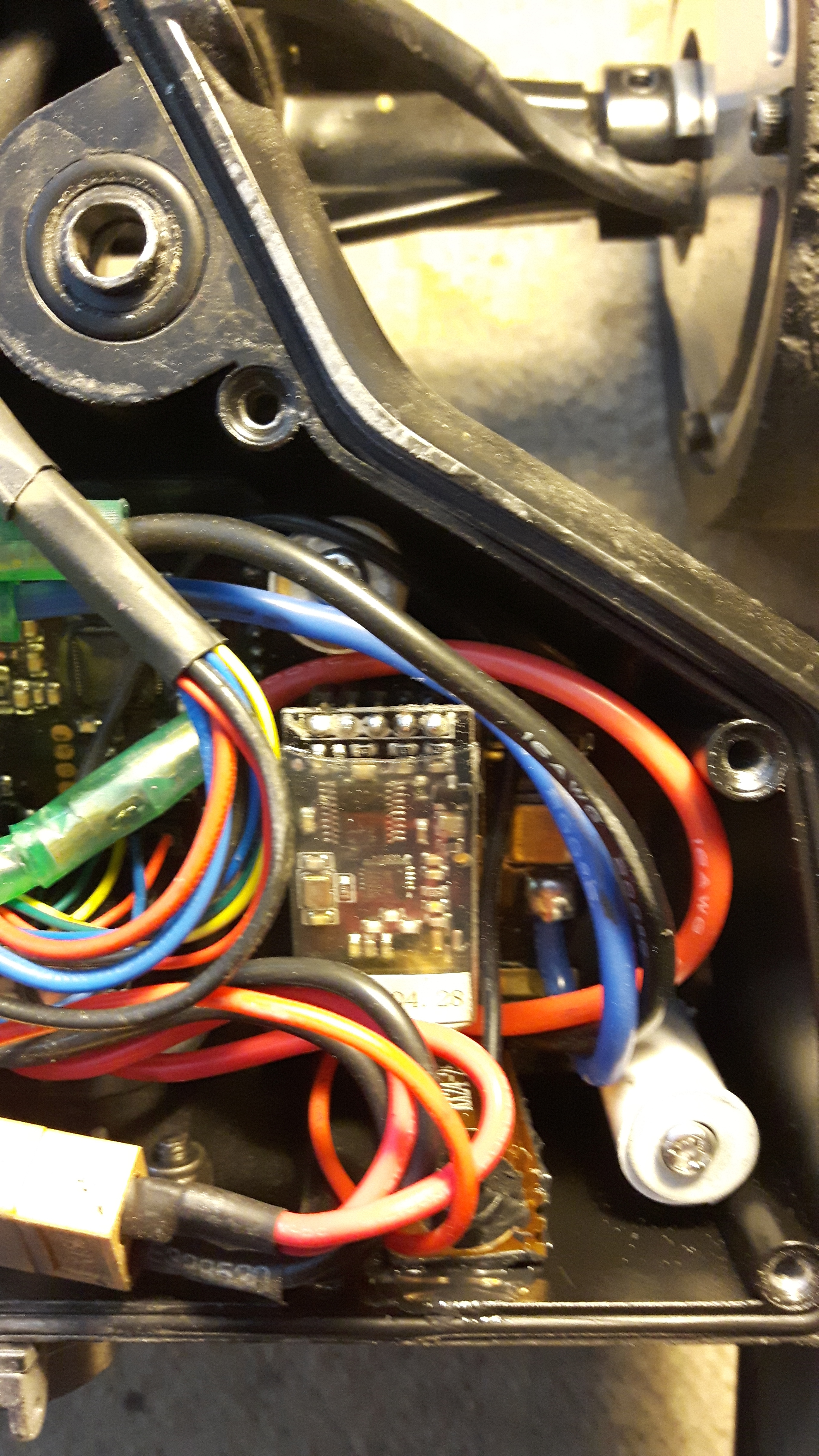

Has someone an idea what happened to the receiver?
Where the hell comes the oxidation from? There was no water inside- never.
Edit: sorry for the bad pic but my camera is gross.
Double Edit: I think it was bc of going downhill way more faster than my board can go, hit the breaks then and seconds later my fantasy ride began. My board can do 40kmh and i was something around 60kmh when i used the breaks.
Read something like this on a @MoeStooge thread and i think that was pretty the same thing.

Was first using dual 200a track star ESC and paralleling the RX into a single receiver I had one motor burn down phase to phase on high speed hard breaking on 4096 inrunners. It took out the control board on the ESC and backfed through the RX wire parallel to the other ESC taking it out of commission as well. I use two receivers now because of this.

Metal will always oxidize so long as it’s exposed to the air and if there is any sort of moisture in the air (high humidity) tends to cause oxidization to happen more quickly, but even without it things will eventually start to combine with the oxygen in the air and become rusty. If it is just surface level rust this isn’t a major problem but in many cases with metals the oxidized/rusted part begins to flake and exposes more fresh metal to oxidize underneath it. Galvinization is the process of coating another metal with a zinc layer because although the zinc will oxidize on the outside layer it doesn’t flake and won’t let oxygen get into the lower layers so easily, the oxide layer on the outside protects the rest of the metal. Since galvinizing our stuff isn’t really practical next best bet I think is conformal coating, so you cover the metal with something non-metallic and non-conductive that will insulate it from the air. I think conformal coating electronics boards is probably pretty standard for things like cars and other vehicles that will be outside all the time and tend to see a lot of different air conditions as they move around in the world :slight_smile: but isn’t usually a step taken by factories when making hobby electronics (extra steps is extra cost and some components like barometers don’t take well to being conformal coated so unless it’s asked for it isn’t done)
Regarding your sudden burst of speed into ludicrous mode when trying to brake hard to say what went wrong but if you have telemetry/metr on there it includes the PPM info if you upload your data can see if the PPM went wacky before the thing decided to take off or if it was something else. I’ve had cases where I was messing with config and set positive values some unexpected places or negative values I forget but was flipped basically for regen braking amps and ended up pushing power into the motor instead when I tried to brake (was consistent issue though so easy to pin down in my case and fix)
