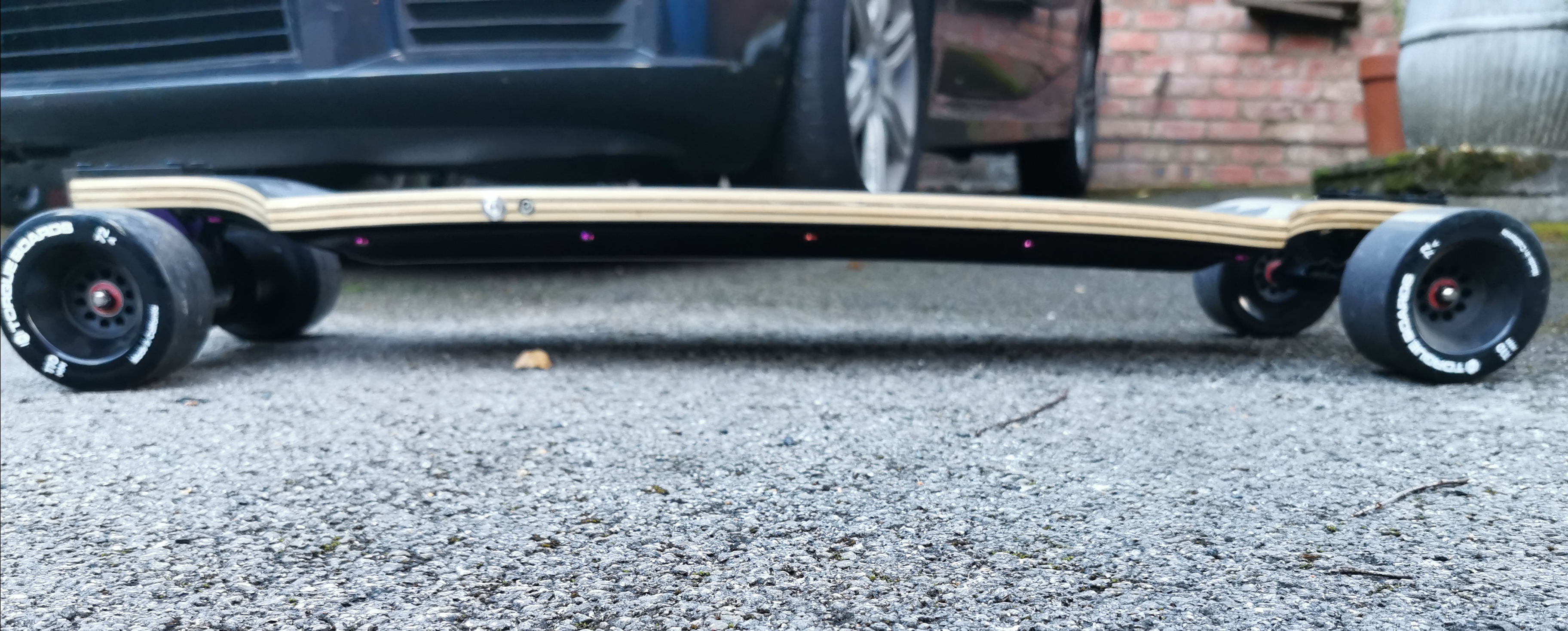

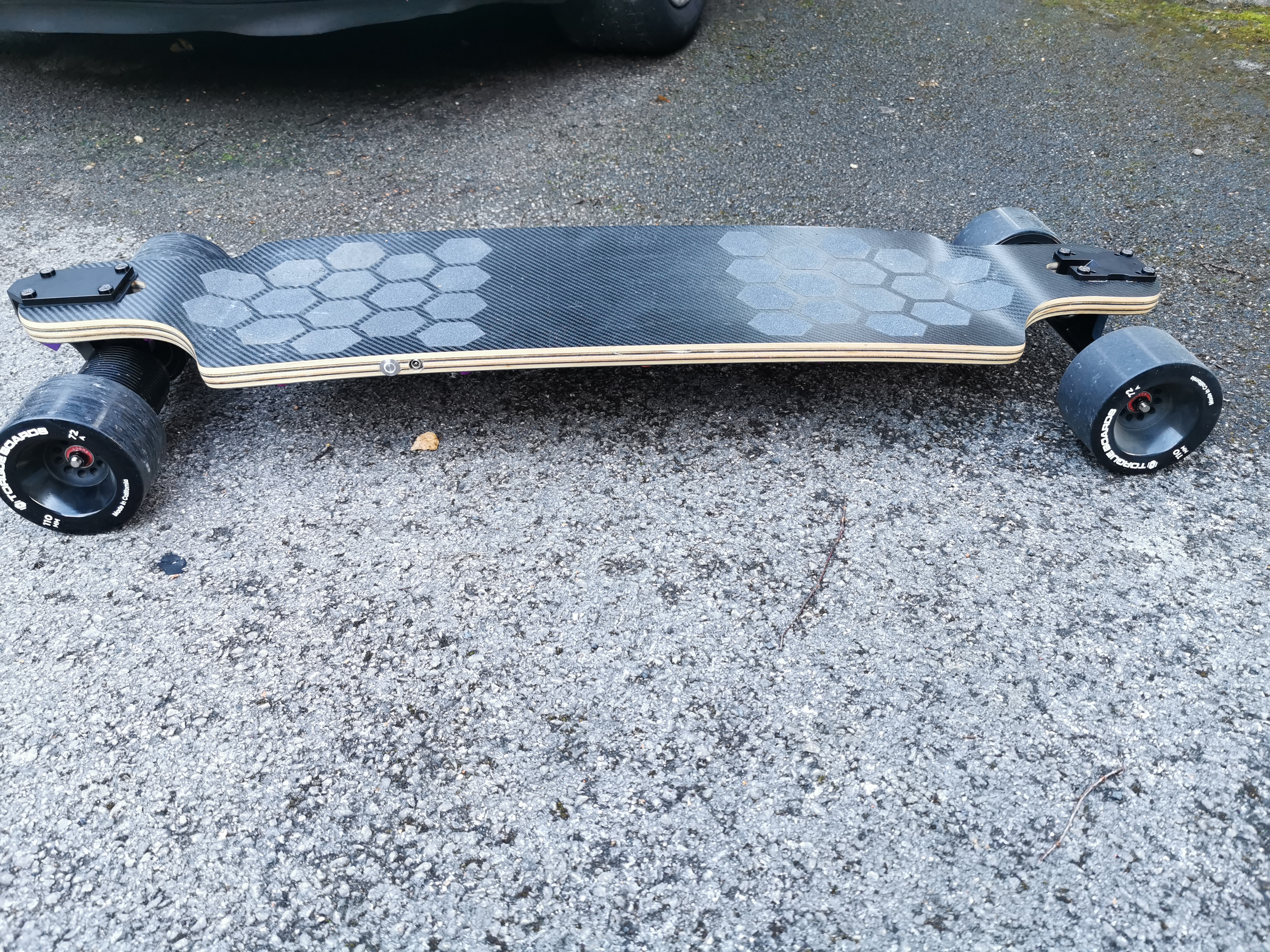

Is there anything fundamentally wrong with having the rear of your board <20mm (I think it’s about 10-12mm) higher than the front? I went down the rabbit whole of top mounting DDs and I think the best I can do is going to be about 2mm lower than the below:

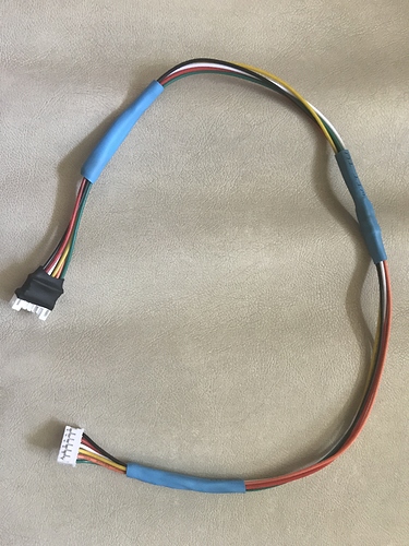

Another question, I have to change out my esc connector, do I just cut off the part where the heatshrink ends and resolder the new connectors?

Yup just lop them off nothing really special to the connectors, they are just big enough bullets to carry required amps. I like the mr-60 from amass though soldering into the slightly smaller bullets so close to each other isn’t super easy it comes out nice and clean. Ideally stick to female side on the esc since power coming out of there usually you want female plugs for power coming out since harder to short those than male side, male side takes power in ideally.
Only thing to take caution on is if cutting battery wires do one at a time and tape back anything not being worked on otherwise can short power through your tool (easier than you think and fast it will spot weld your cutters in an instant and the short is bad for the battery health on top of it)… So yah one at a time if work on live wires or battery.
Okay, just checking since I wasn’t sure, they came with the motor, so I know they will work lol.
Luckily @Skyart warned me of that when I had to splice wires, so good thing I knew
No, but it’s probably better if either side is higher, for the front to be higher. For reasons of staying on the deck while braking hard. It really doesn’t matter very much either way though.
It hits hard in the “looks / appearance” department though…
It’s ugly but it works
