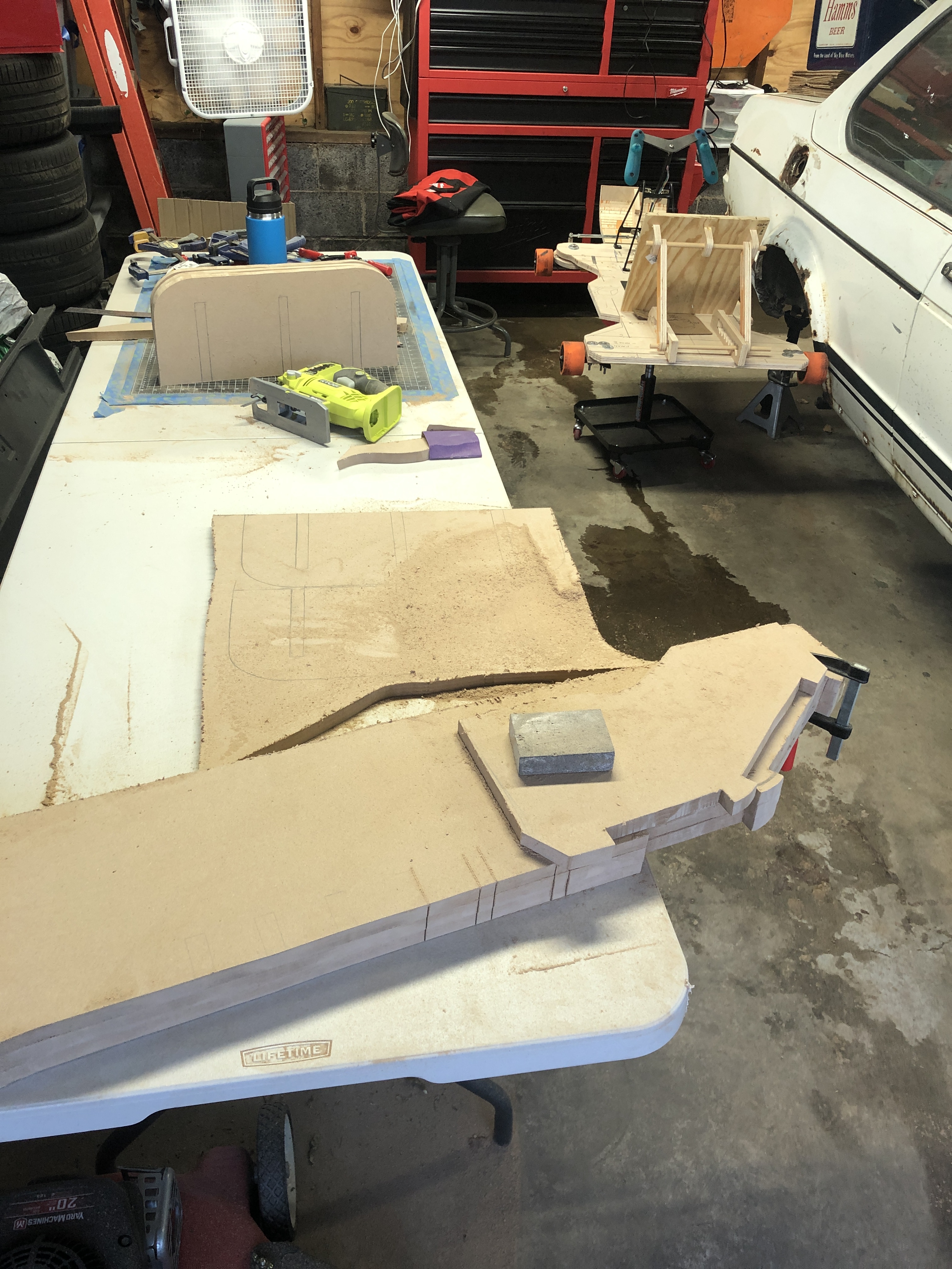

I want to put a drop and light concave into it, so I’d like to make a proper 2 part buck mold from plywood…then I’m going on park my car on it

I was planning to make a giant 2 part mold and park my car on it, 6 layers of Canadia maple veneer and 2 layers of fiberglass (no idea what types or thread count yet) on the 2nd and 7th layers… probably hot water pre form then paint each with Titebond III, then epoxy the FG layers in

Parking on top of it probably won’t work. You need and even distribution of the load and I’d bet a dozen screw clamps would create more clamping force than a single car tire and partial weight of the car. Some pieces of angle iron steel might help as well. Forming the whole deck at once will take a lot of force. Adding moisture and heat changes a lot, but introduces other problems too

In terms of pressing, I guess hot water, press (ass load of clamps), wait to dry, lather in glue, press again, epoxy GF, press a last time, cut out (I think I’ll have access to a 4’ square CNC, then card down fabric?

If you have a 3D printed and are planning to design this in CAD, you could take slices of the board and print those as thin templates for drawing the shape to your mold
