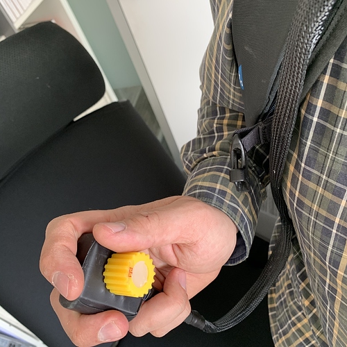

Stealth electric backpack (done, but not final / WIP)
Wide wheel hubs
Wired remote (if ever, this’ll be a side project)
