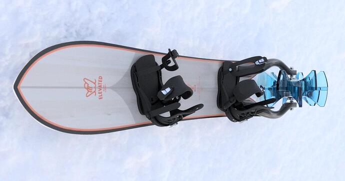

@malJohann Morpheus build was a battery in a backpack. obviously you fall much more in snowboarding but if you use nese modules and/or protect/insulate the pack i can’t see an issue tbh.
[image]
Times are changing, and my quiver might finally go from one to two. So the new Haero on the scene resulted in this new thread, which we’ll follow to see how deep the rabbit hole goes.
More changes to come (hopefully all this year), in no specific order, these and the deck change is why I decided to classify this as a new build, plus my TIE fighter will return.
