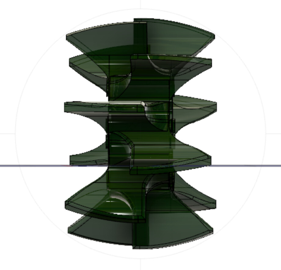

“Football wedge maximized surface area”
Suspension: Shore hardness determines flexibility. We will make them as loose as possible without eating the board. The first ones have 150mm travel.

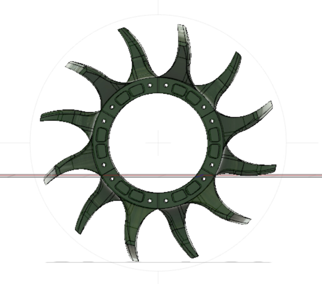

We have 2 other prototype designs this is type 007
008 is switch blade design (We might skip this… afraid snow may jam) This was my concept for the product designer.
009 is improved 007 design with 20+ less parts, 20% less mass, smaller diameter, same surface area.
The stators… 1600w vs 3500w
