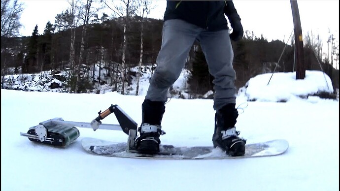

What’s the green material they use for the traction? (The piece that turns and has the metal claws attached to it)
Pedrodemio - Seems spot on.
Working to add torque and reduce weight, diameter without losing surface area.
I want to try a different controller, can’t get the amps out of what we have.
UPDATE:
updated to the 3500w stator.
Needed to machine a new case due to longer magents.
No more saturation but seems not enough current/torque.
If I push start it she spins like a banshee.
I added wire between the motor and controller, could this affect output?
- Going to try ebike controller designed for the motor.
 - Try Trampa 100v controller
 - Alt design in progress. Reduced parts, size, rotating mass.
 - might mold paddle directly to the 1200w hub.
Are you running sensored?
Yea, sensored. Tried BLDC too.
not enough torque to start on astro turf.
I am thinking to try my old VESC and short cables.
Lost torque when I changed controller and added super long 8AWG motor to esc wires.
Try keeping one independent variable.
If you use the old controller with the super long 8AWG phase leads, did you lose torque?
This helps determine whether it was the ESC change or the wire change that cause the end-result.

Thinking the controller is the issue or at least it’s not detecting properly.
Need to try and detect the motor with another controller, ordered an e-bike controller designed for the motor to compare. Hopefully, I can detect with the 4.20 it seemed to run better with that setup than the Flipsky 75/200.

Keep in mind that most generic/cheap ebike controllers DO NOT regulate motor current and only regulate DC current from the battery. This leads to the experience of massive starting torque(controller just dumps as many motor amps as possible) and then reduction of torque and limited top speed due to the DC current regulation. This is also why these kinds of controllers typical do not last long and are prone to failure since the unregulated motor current causes massive transient voltage spikes and also stress the motor out.
I’ve already experienced several customers that have a mistaken perception of the relationship between current, motor torque, and several other system variables due to the fact that their only previous experience are with these unregulated cheap/generic ebike controllers. Don’t fall into the same trap.
@shaman I tried to get some FOC numbers out of the old controller since it seemed to work.
Once I wired the old controller to the new motor and flashed it. It seemed to detect it with a super smooth detection.
After it detected I adjusted the rest of  numbers and the TORQUE was back no cogging.
It was either the Fing controller or the long phase wires. Going to try the controller directly to the hub next.
Need to find a production controller to push these hard. @shaman
@shaman We didn’t want to use the ebike controller, just wanted to prove our motors worked.
We wanted VESC for the wireless controller.
Hopefully, we can find a controller to push these 17s packs.
