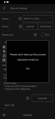

Connecting went good as always, checking for the metr hw update gave me the option to upgrade from 5.38 to 5.39
FIXED - Started update - instantly went to jumping into bootloader 0% - operation timed out - threw me to the realtime data page with the error RESOLVER_DOS
Atfer restarting the board and killing the metr app it just showed “metr pro can - connected” but no data transfer as mentioned a few posts above. Restarted everything again and it connected.

Can’t update firmware of module
App: 4.11.15
Metr pro can SD + gps + lte on unity fw 5.2
Metr fw 5.38

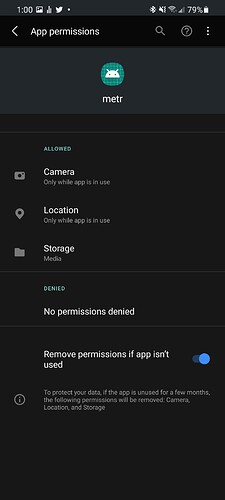

My regular metr pro still works fine but I still have no map data

It can be a lot of things, but let’s try to figure it out:
Is location permission is granted and location services are on?
Are notifications are enabled and you have foreground notification on the lock screen?
Optimizations turned off?
All of these things are good - it hasn’t been working for like 6 months at least
I’m considering reinstalling the app but I don’t want to lose my records
Reinstalling is questionable. Don’t see how it can help. Do you remember this? The Definitive Guide to Metr App / Metr Pro - #824 by brown5tick Did you find any related setting on your phone?

@ShutterShock 6 months! I am sorry and please keep bugging me about this issue, I have to fix it! @brown5tick join forces!
Yeah it’s annoying lol but not the end of the world it just means I can show maps on videos
Here’s some screenies
I’m pretty sure all my settings are good
