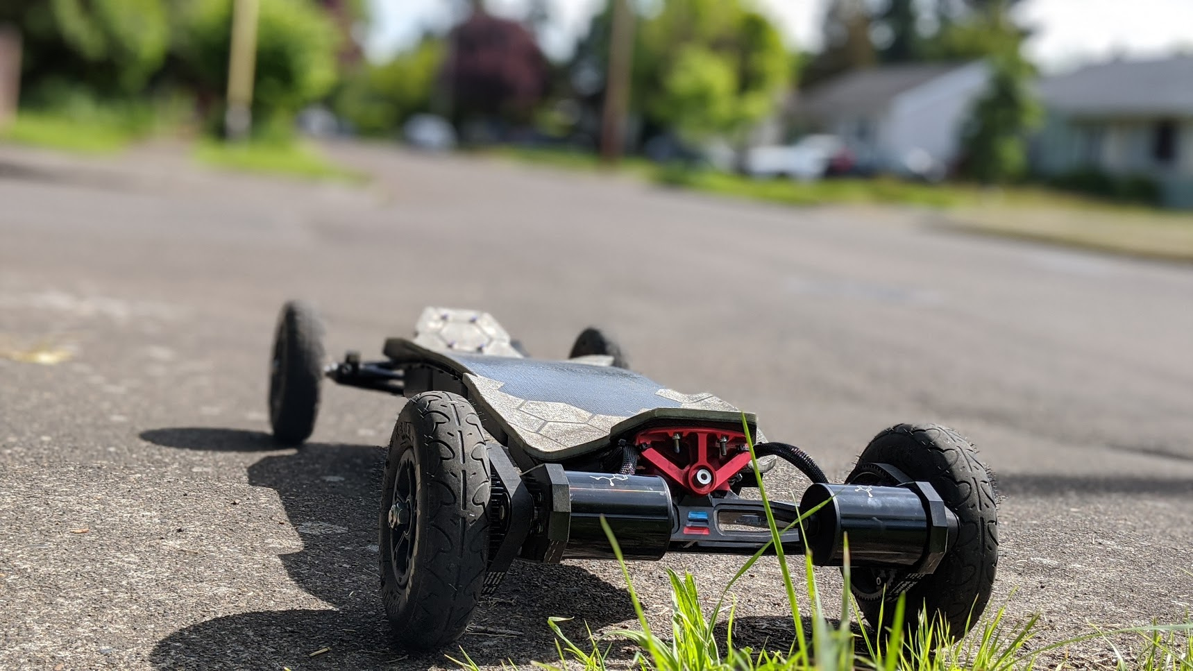

It is really hard for me to bench a board that has zero issues, but I finally brought myself to put LoveChild up on the bench for some maintenance & upgrades.
Fresh Motors were top on my list. The original ones I’m riding were beaten & abused by the Lacroix boys in the first Lonestar prototype before they got hand-me-downed. They seen some shit. They seeeen it.
Also put in some new Juiceboxes:
Also dropped in yellow/red bushings. I need to give them a few weeks to break in but so far I miss the rowdiness of the blue/white combo. Bleh.
I should probably get around to redoing my griptape (I mean begging @SeanHacker to do it for me).
Did you have the same motors before? How hot do they get for you?
I can cook eggs&bacon on mine after going 30mph+ for 5 minutes.
Same 190KV motors (lacroix inventory). Yeah they’re very effective space heaters. Sealed motor cans, kinda to be expected with that much copper. The 140kv version at HV is going to be interesting to test on.

I feel like the physical robustness of these motors makes up for the extra heat they produce. My old ones are absolutely hammered but they still run great- just sound a bit too loud at this point from the bearings being a bit shot.
Yah, me no running temp sensors and also open can SK3 6374 192kV’s. Interested to see if these run hot.
Isn’t it better to gear down than to get a lower KV motor? Almost all motors I have seen have lower wattage for the lower KV variants which will put you back to square one.
Yes/depends what you are trying to achieve- but those are two very different things, wouldn’t use them interchangeably or even comparatively. Not my intention there regardless-The 140kv board is a different setup entirely and is part of my Stormcore 100D beta testing plans.
That’s why I wanted them, love how tanky they are, just didn’t expect heat to be such an issue.
The exact some motor with an open can would be perfect. I’m debating just drilling some holes in mine to “unseal” them. Not sure if it would help much.
By disabling thermal throttling do you mean raising the temp cutoff start or something else?
I’m not 100% sure it can be outright disabled on vesc firmware (it could on old unity fork) but you can change the beta value to something unattainable pretty easily.
Agreed on the motors. Had the same thought but I don’t think there’s any easy way to modify these.
They are basically identical to the Torqueboards 6380 in terms of stator size. The biggest thing they have going for them is the bigass forward stator-bell bearing. I can confirm over 5k miles on my first set of these though- and generally speaking my motors tend to start to die/cry around the 2-3k miles mark with a couple of exceptions.
You think drilling holes on the side of the bell is a bad idea? Even a little bit of airflow on the stator should help massively I think.
Add 3D printed fans while you’re at it.
I think my SK3’s run so cool because they’re open can and have an integrated fan as stock, and at times I’m pushing over 5000W through them, definitely not something they’re rated for.
