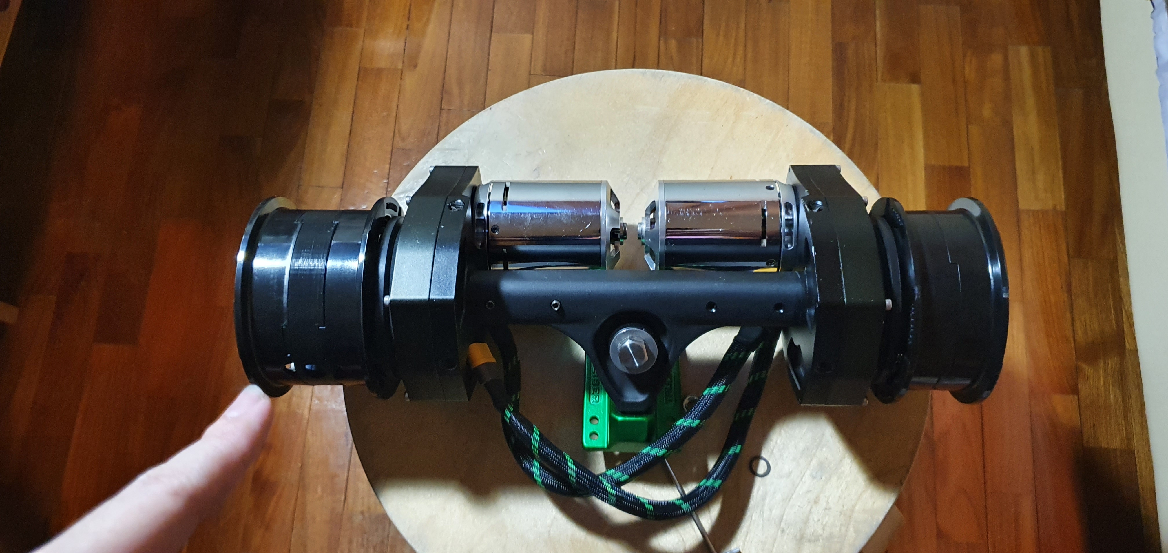

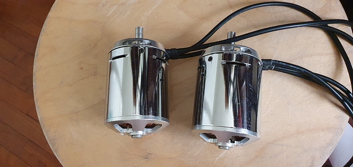

Installing the motors, and setting up the gears. The SK3s i have are the sensorless ones, and i cut and extended the wires with 12AWG silicone wires.

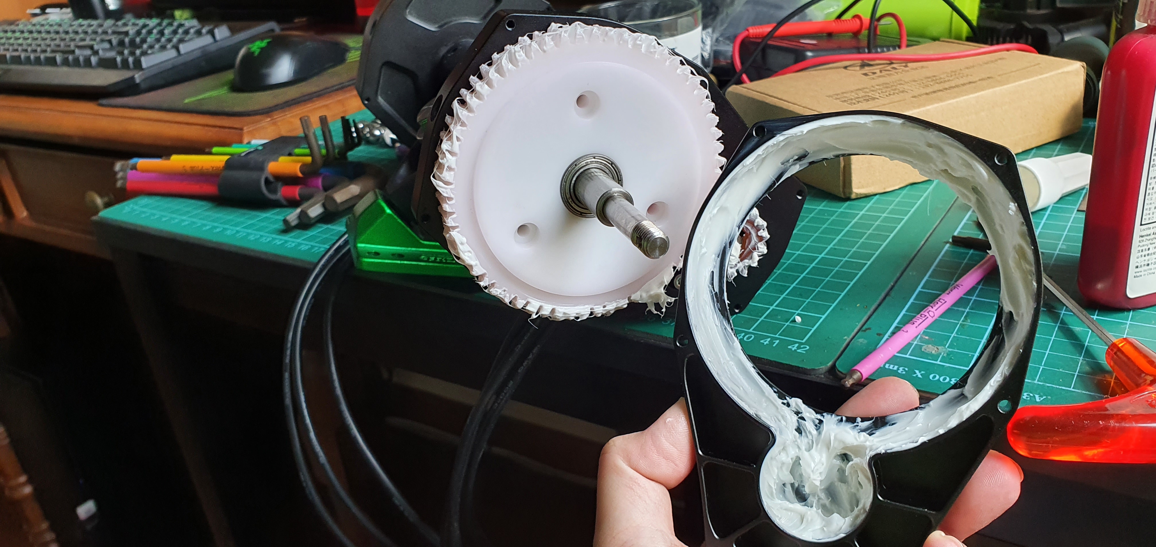

Splooge retaining compound on the pinion
Set backlash, and grease everything up

Now for the fit, surprisingly not as much of a headache as i thought. There’s a bit of an interference so i’ll have to mess with it. Also, i did not have a genuine Superstar so i used a Sunmate hub, dimensions are relatively close and snaps into the adapter.
Then it was time to test the hub spacer. Big thanks to @Pedrodemio for the model.
Having the hubs stretched, gives the wheel a better contact patch to the ground, and on a track, grip is key.

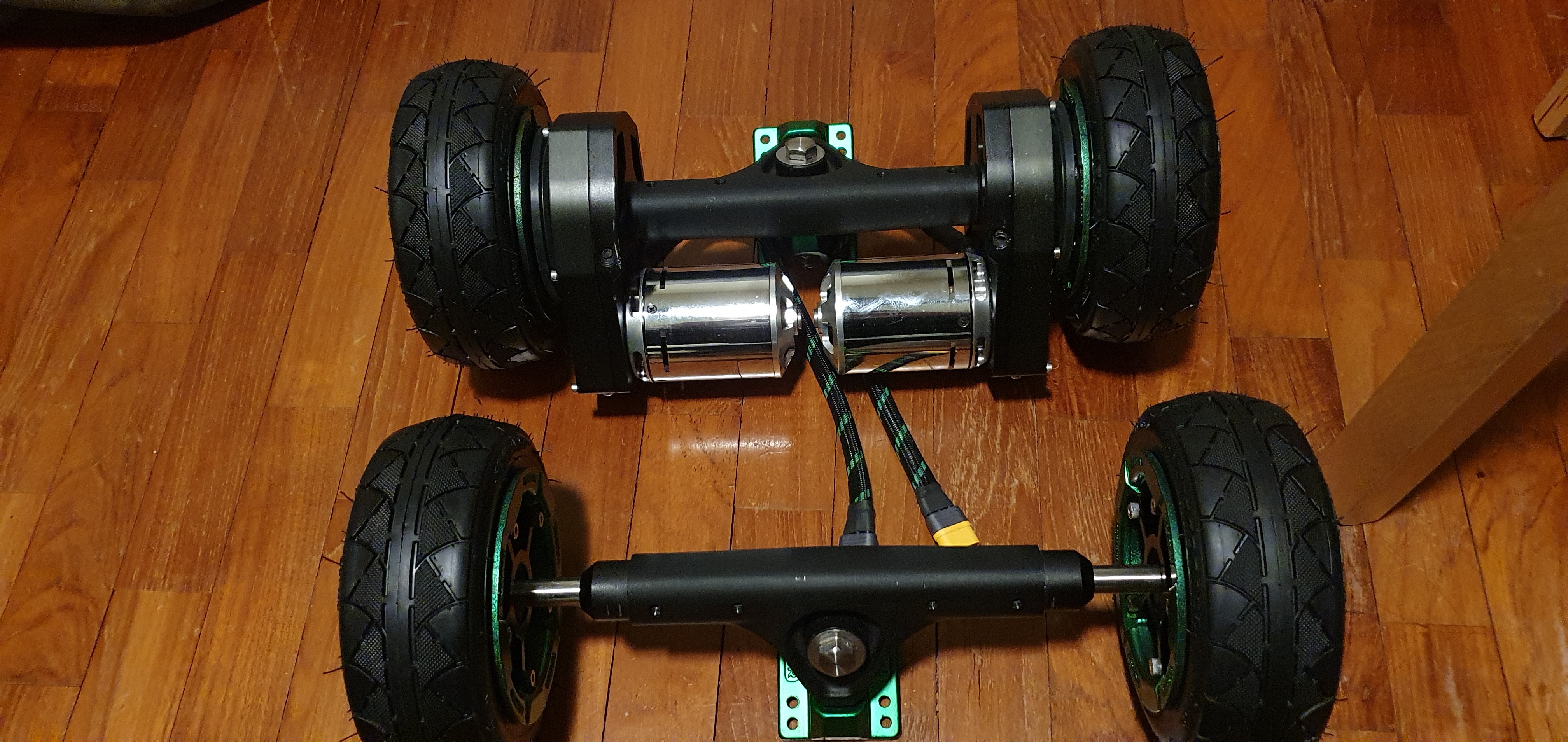

Trampa hubs came with the 8mm spacer, so I test fit the hub spacer and hooked it up to the drive. Fortunately, everything fits! With zero modification as well. I was certain I would have to cut something on the hanger or something but it all worked out. Metroboard tyres will be here in 3 weeks, so meanwhile I’ll do some magic to the hubs

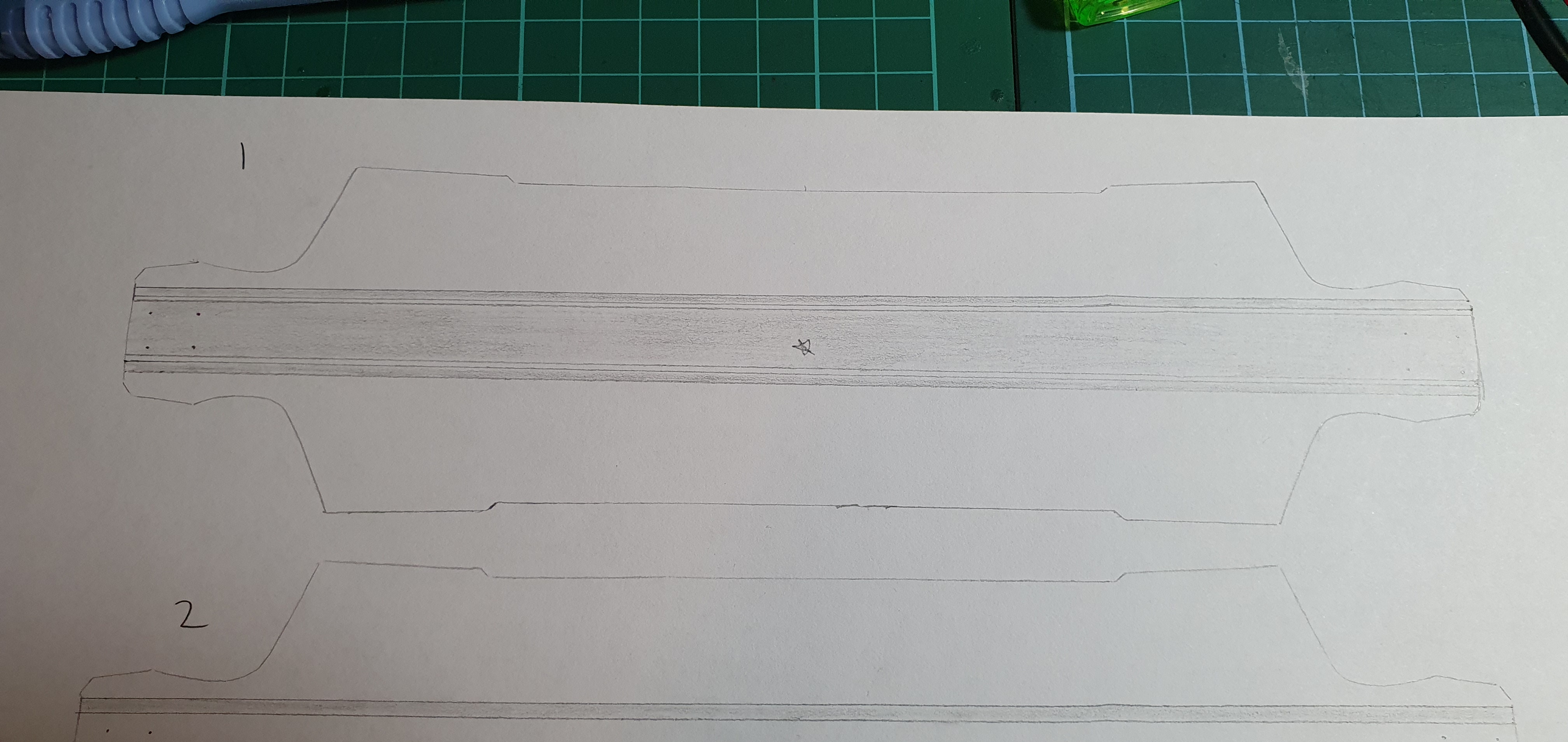

So, as the deck is going to arrive soon, i’m currently in the midst of thinking of designs to go on the top of the deck, so i sketched out a few and brainstormed. Perhaps you guys can help vote, or even inspire me with different designs. Trying to go for like a racecar stripe kind of look.

3rd one looks cool, but it resembles the Bamboo GTR, so maybe lets go for something unique. The thinking continues…
What about combining the big strip in the middle with the 3rd one?
It’s been done already
Hahaha that’s a good one. I’ll continue to sketch out a few more designs and see. Still am not satisfied with the first few

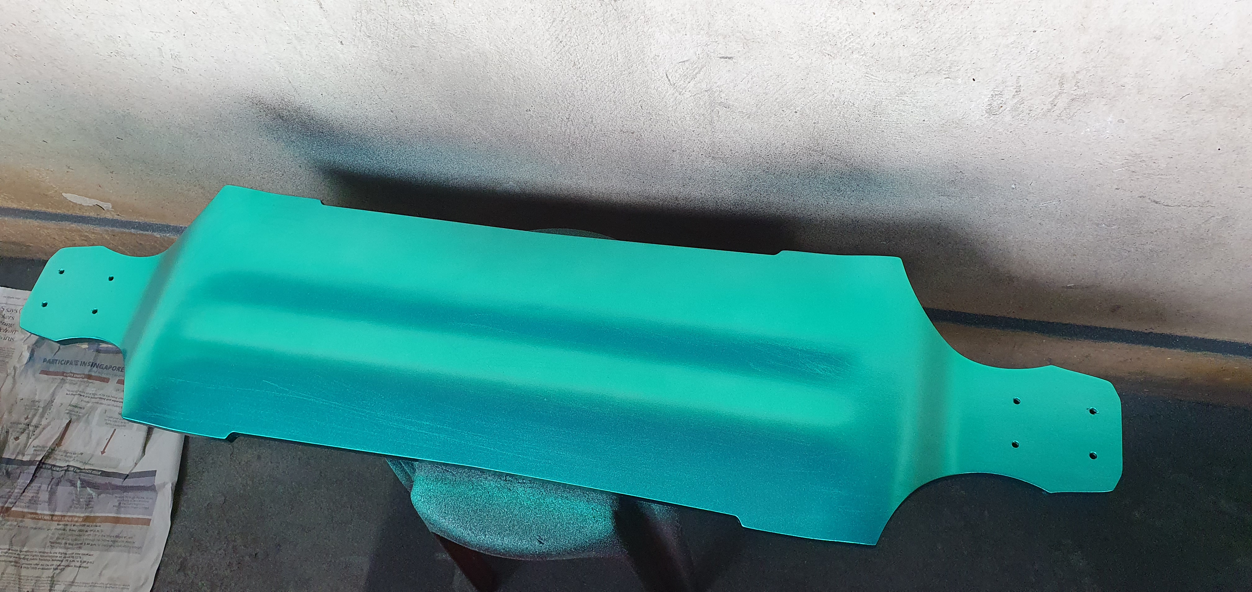

Now to remove everything one last time, to paint the top of the deck.
And the deck is done. Once again, big thanks to @jamie for coming through with this Redember 44, I stood on it for a bit upon opening it up and the deck just feels amazing. Hope I did the deck justice!
