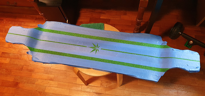

What is this beautiful paint at the deck’s bottom?
Did you use some sort of spray-on grip?
I used truck bedliner on the top of the deck as my ‘grip’
Then I spray the same colors over the bedliner.
Its a brand called samurai paint. Might not be able to find it easily unless you’re in Singapore or Malaysia.

Quick question. How do you cut the ganja pattern? Do you first put the tape on the board and then cut it? That seems like it would be pretty difficult to do.
Thank you! I have a template which i had cut in paper, then i find the middle of the board, and trace it onto the painters tape with a sharp pencil, then cut out with a ruler and sharp craft knife.
Right. But when exactly do you do the cutting? It looks as though you have done it after the painters tape has already been glued to the board. And that seems like it would be difficult to do, since (1) you wouldn’t have a flat surface under the tape and (2) you wouldn’t be able to completely avoid cutting into the board.

Ah, forgot to mention that. I paste the tape on the deck first, then I trace and cut the shape out. The bedliner surface is fairly tough, so having the blade touch it for a bit is fine
