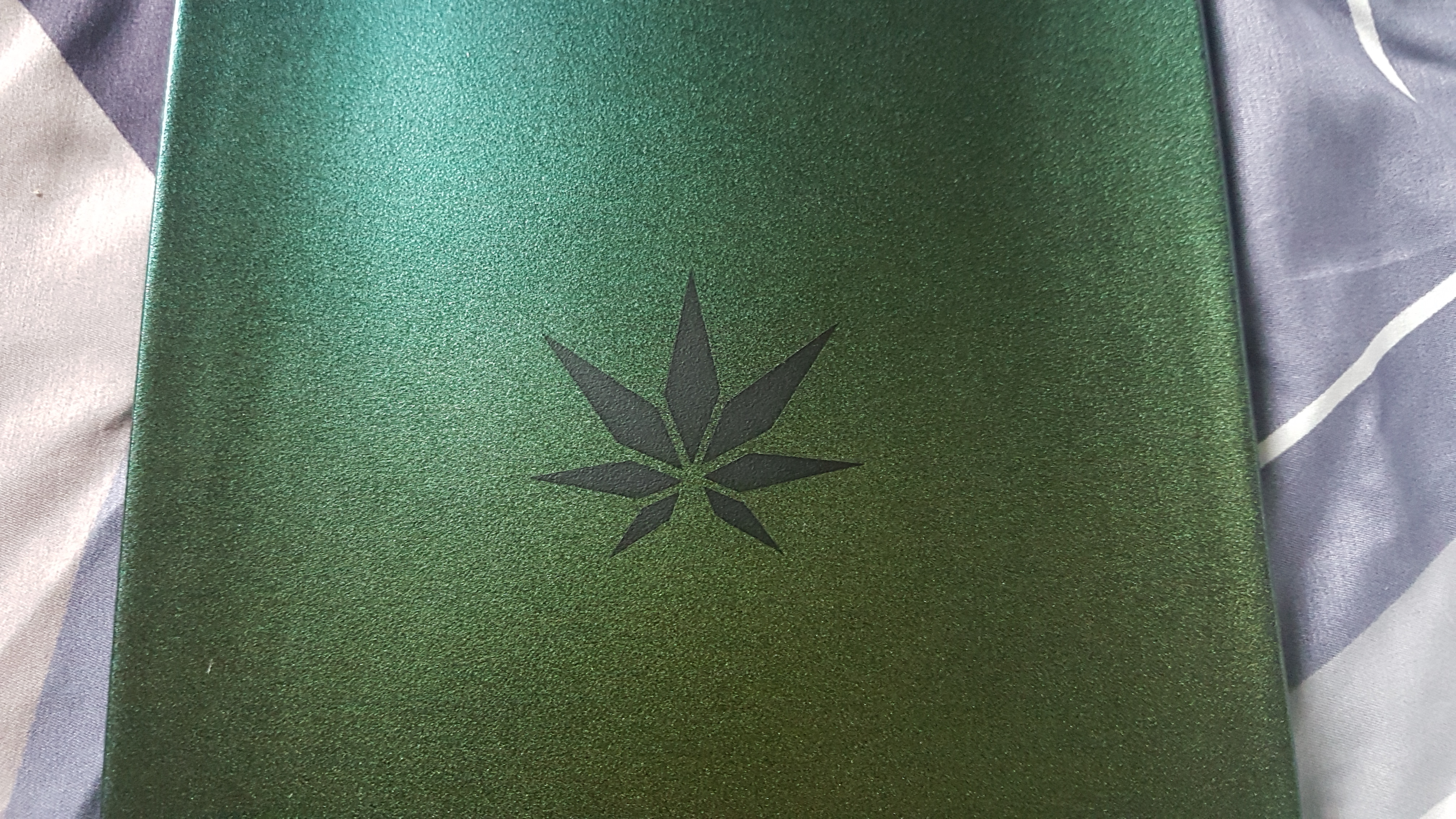

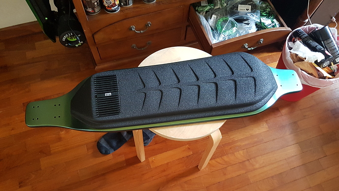

Enclosure came first so i worked on it, stripped the black paint and did my ol usual with truck bedliner spray
Then came the deck. I got it from someone locally who initially bought it to use on a downhill set up, but he ended up selling instead so i swooped it.
Stripped and sanded it to get ready for paint.
BOOOOOOOM. Experimented on a color shift paint that changes from green to blue depending on the angle where you look.

Back to the deck. Trying something out.
Look at the color change

After it’s done, installed everything to the board, what’s missing now is the battery.
10s4p pack is done! There’s so much enclosure space haha.
Went downstairs for a test ride. Dropdown decks are the best.
And it’s done! Here’s some finished pics.

Mmmmm… delicious. Final weight is right smack at 10kg surprisingly

It’s sooo not glass fritted now.

Wait what happened to the frit?
It looks alright in the photos, but in real life, i guess i added too little frit and too much clear coat, it kinda looks like measles?
So i stripped it down and redid the whole thing, but spraying truck bedliner on the top this time, and then my color shift paint over it. I prefer this look now haha.
