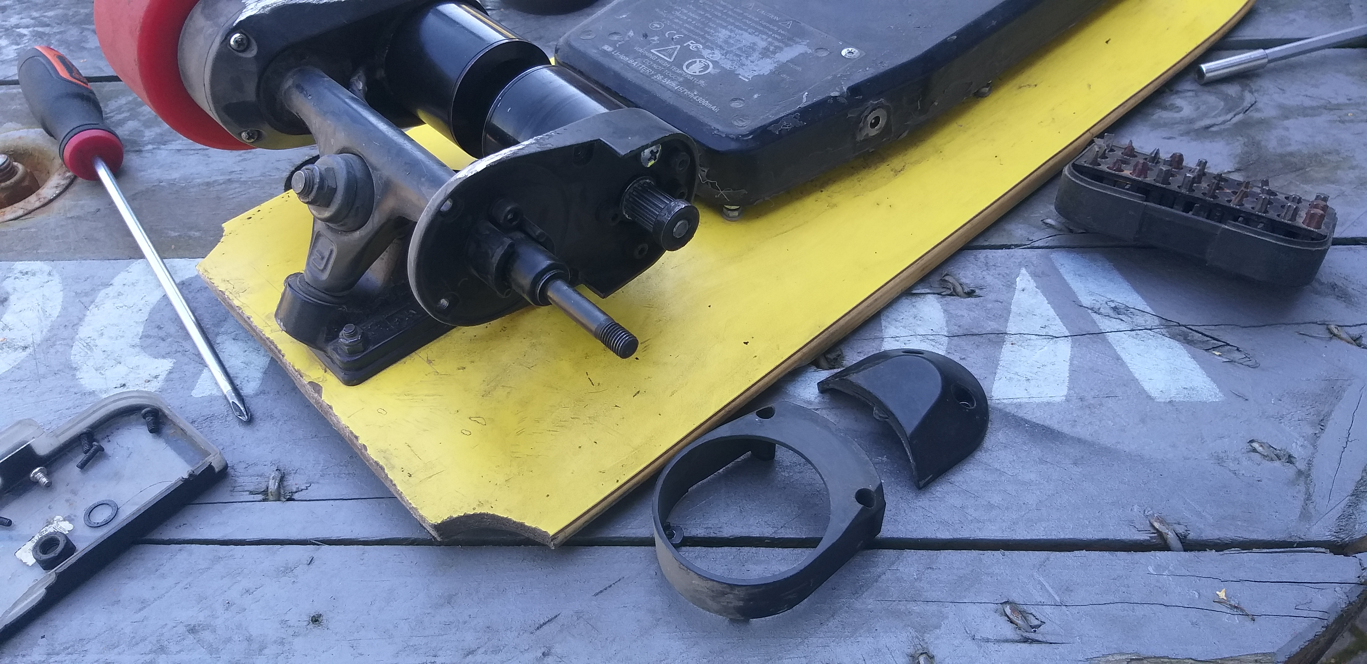

If you look on alibaba you can buy this ‘‘Ifasun dual belt 800w’’ kit for only 300$ (380$ including shipping). Friend of mine got it 2 years ago from another chap. Seeing that this kit does the job I bought one for myself aswell. Now here comes the mistery. Why are the kits different? Is there an older version of this kit or different manufacturer that has copied original design?
From outside main difference is completely different belt cover design (newer one has two peace cover, old one uses single). There seems to be thicker main shaft of old trucks. However newer one has improved motor mount mounting with welded flange. Wheels are thinner as well on newer kit by 4mm.
Maybe somebody knows more about this manufacturer?
The default setup of this kit is a deathtrap. Original ESC has 1 second delay in response for both acceleration and breaking, both motors and controller overheated a lot and drained battery really fast (barely could ride 6km on full charge). Replaced esc with diyeboard foc esc (was a bit tricky to fit in), and improved things drastically with 17km range on normal ride routine (aggressive ride would give 14ish km’s). Ride comfort improved drastically with it as well. So far have rode 200km’s with kit. Original wheel bearings failed after 170km’s ( they however had really bad rattling after only 30km’s). And I had to replace main motor bearings. If anyone’s interested I can add info about that as well. In side of good things, rubber bushings had silicon on them, and screws had loctite, motor mounts are pretty solid aswell. So far I have mixed feelings about this kit, looks neat but takes lot of work to get it to run reliably.
Regarding friends kit, his has lasted lot longer without any issues (also has better esc), however it is unknown what things have been changed or modded on his by the chap who originally bought it, ill share info once he upgrades his to dual vesc setup.

And it will be unreliable as long as vital parts aren’t swapped. The general consensus on here is going to be that it’s not worth the hassle. By the time you replace everything that needs replacing you’re pretty close to a decent diy build anyway. That said …
As far as why things are different, well probably just because the manufacturer sourced cheaper parts elsewhere over time.
Nice job on swapping the esc. Those numbers you mentioned are insanity! Any idea what kind of battery is in there. Careful with no name boards using cheap bats that will endanger you and yours. Sounds like you’ve had good luck so far but I would look at the cells of you can get in there.
I’m a bit out of the loop, but are there trucks thin enough to snap on hardest impact? So far where I live I have quite shitty roads and no bends or anything.
Did a quick mesurment on thinnest part.
Old trucks front: 21mm New trucks front: 17mm
Old trucks back: 23mm New trucks back: 19mm
So 4mm loss on new design, have nothing to compare this to saddly to know if it is good or bad.

The worst part about this kit is the design, it looks like design copied from boosted board V1 (3M belt, full belt enclosure), however everything is made in a little bit different sizes. Driver pulley is 16teeth, Wheel pulley is 52 teeth (boosted and pretty much any other standart is 48) Even the belts are this weird standard, only thing I can get in europe from gates is 225mm belt:
There is also pretty much no room for tensioning belts, about 2mm if you are lucky. Wheel core is hybrid between ABEC and ABEC clone cores (somwhere in middle), luckly I have 3d printer available so Ill soon change pulley to kegel core one.
Overall my impression is that kit looks slick and well thought out, but everything lacks polish in both design and assembly. In future i doubt ill add VESC’s or anything, the ESC I have now gives 37km/h max and 8-25kmh time of about 2-3seconds which is totally fine. Time for new build.

Old design is way simpler, doesn’t even allow any belt tensioning. I swapped my upgraded controller. Turned out old motors themselves have bit higher KV (37km/h on new board vs 41km/h on old motors seen in picture). Motor construction is a lot reliable as well and barely any rattle present in motors. Just recently one of the motors developed some odd noise, will have to look into that.
Regarding my setup, it’s still going, belts are skipping when breaking and there is no way to tension them, so I’m kinda stuck with driving them into the dirt until I get replacements, but 300km’s per set is OK I guess… :man_shrugging:t2:
