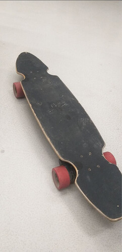

Since at the time of purchase I was piss poor student I had no deck. Friend of my had 2 decks. One was cut down downhill deck, other was deck that he rode car on top and snapped one side. First one I tried was shortie with right bolt holes so I made this:
Say hello to gopnik board No 1 (those 3 stripes came with the board
, and I mounted trucks incorrectly).As you may expect, it became to short almost instantly. It didn’t helped that original esc was deathtrap. It became boiling hot in first 2km’s, remote had 1 second lag between registering any input. The only thing that worked was the app. Luckily I was prepared for this and based on one youtubers suggestion, installed lingyi esc.
However it was not as easy as I was being told. I had to cut some plastic out and install shims covered with thermal paste between cooling plate and lingyi. Ended up just barely squeezing it in. All of the struggle was worth it. Board was responsive, no lag, 14km’s of range regen breaking etc. My fun was cut short. Couple of days later, on my way home, classical Latvian rain stepped by and almost ruined the board. So I started waterproofing. The image you see above is after one month of driving with my waterproofed version of case. After reading horror stories of rubber gaskets failing and water getting in I did what every young gentelman would “If you’re sealing something it’s worth overdoing it”:
I even drenched the bolts in silicone, as well as made sure no water goes through the USB port. So far it worked wonders. I have opened case twice, each time I had to reapply silicone. But so far there are no leaks. I covered board with 3 coats of ‘‘kontakt chemie 71 uethan’’ coating. While I was at it I also changed deck to the 2nd one with snapped of edge. Meet the Esk8-1 or codename E1:
This is her status after +300km’s and daily abuse. If this is shitty DIY worthy, feel free to post it it there.
