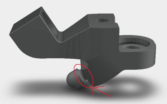

I’m intrigued but the undercut you have on the pivot nose has me worried, most TKP/DKP failures I’ve seen are that fracturing
But it does look like a neat truck, I will give you that for sure
You mean here?
DKP Pivot2
It’s the same dimensions as SR uses which is actually a larger pivot nose than most cast or forged trucks, I think the undercut diameter is the same as an indie truck pivot nose diameter, except these are CNCed so stronger. I haven’t heard of any pivot nose snapping issues (nor had any problems), but if it has been an issue with SR TKP trucks there is still time for a redesign as needed.

While my google searches couldn’t find broken pivots for SR TKP per se, I did reassess the mechanics behind that undercut. SRs don’t just compress the bushings, the holders (and kingpin hole) allow the bushing to slide in the cup. That movement tilts the pivot instead of just rotating it and without the undercut it would compress against the pivot cup.
That said, I am effectively removing that slide action with the bushing holders, so the undercut is no longer needed. I’ve removed it from the design.
I haven’t seen it fail on SRs specifically but MBS, Evolve, WowGo? definitely fail there. But not having stress concentrations is definitely nice :smile:
