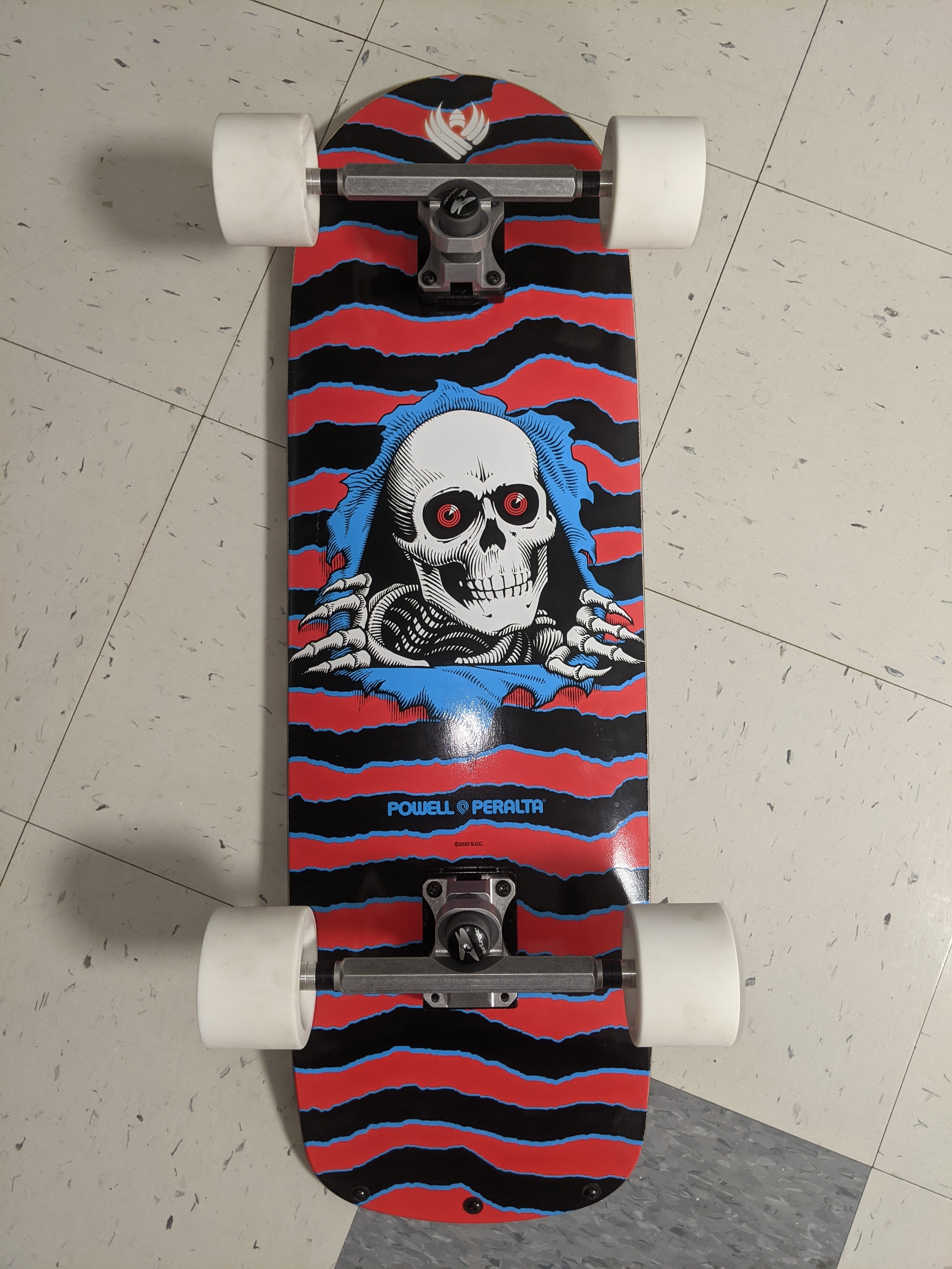

Heya! I picked up this Powell Flight Deck out of a feeling of nostalgia but decided I really prefer the newer style decks for street skating. So I stripped it back down and thought, wtf, lets make it into my first electric.

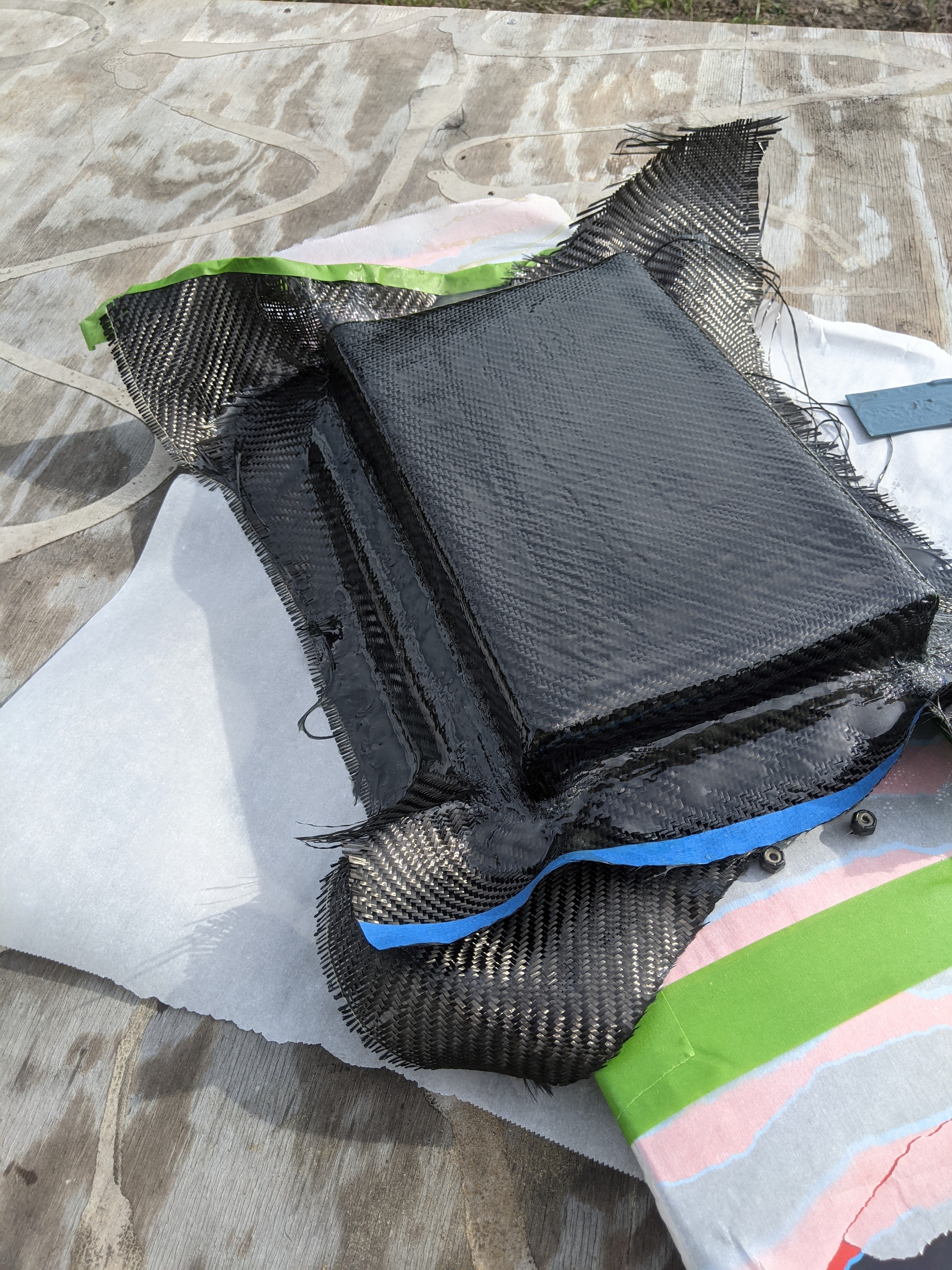

I know I’m kinda doing it bass-ackward with deck selection first, but looking at @b264’s builds I feel like I have a good foundation to steal from. I’m a 48 yr old skater so I have a helmet and pads already (learned I’m not indestructible a long time ago). With the shape of the deck I knew I’d have to suck it up and make a custom enclosure as well. Luckily I have a bunch of kydex and carbon fiber floating around from other hobbies so…
I know with a carbon fiber lined deck and a carbon fiber enclosure I would be screwed on RF signals, but I am planning on running about 4cm of antenna to the top of the deck under the grip tape (in a tube). Figure this way I would get little noise interference to the esc while having the receiver antenna closer to the controller sitting in my hand.

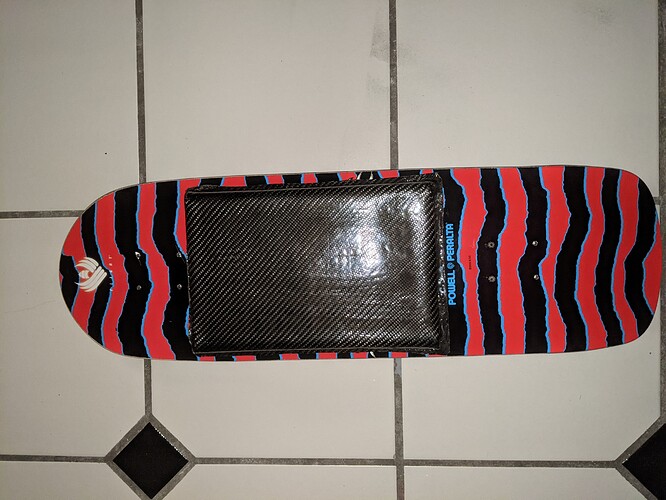

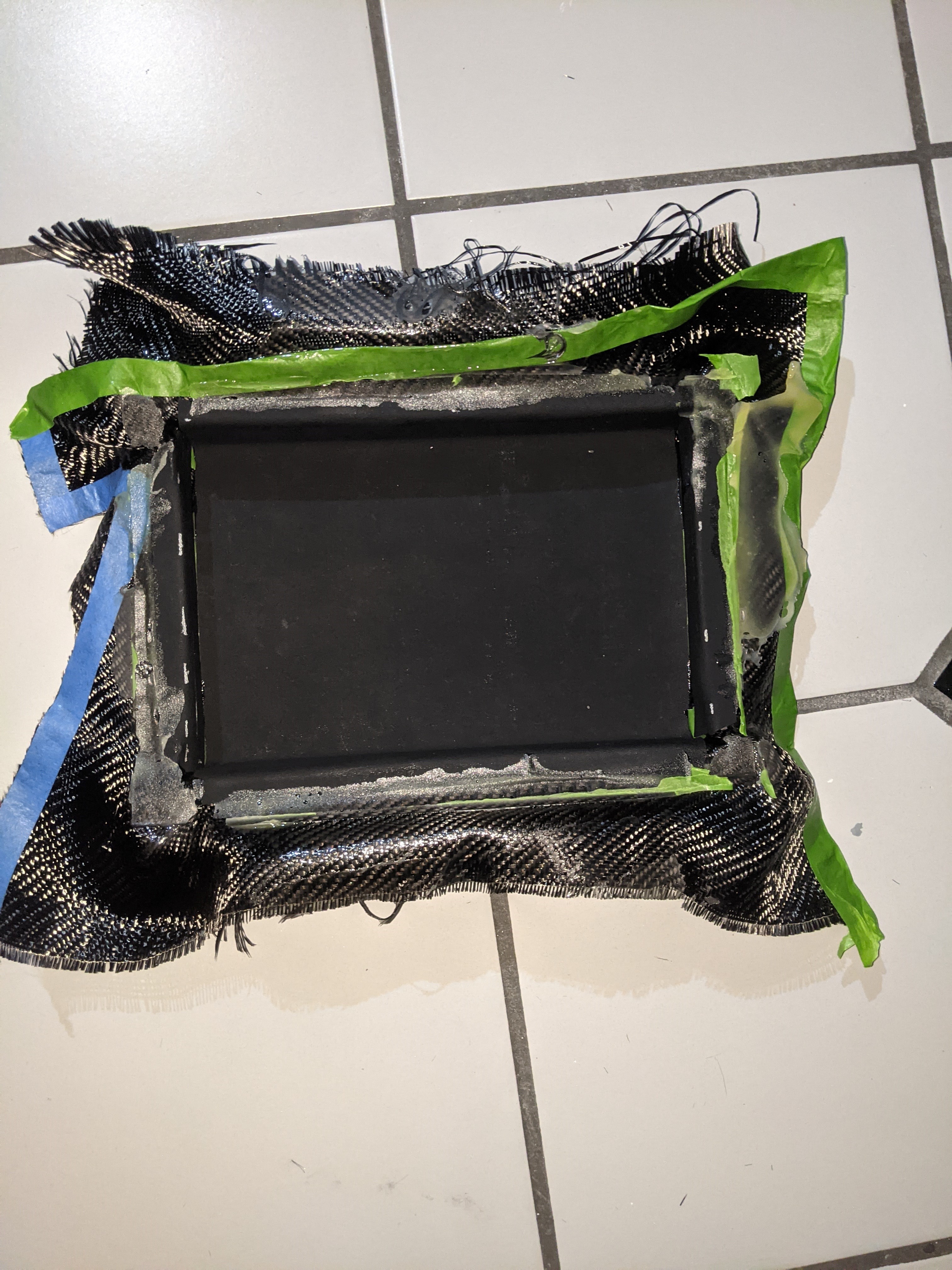

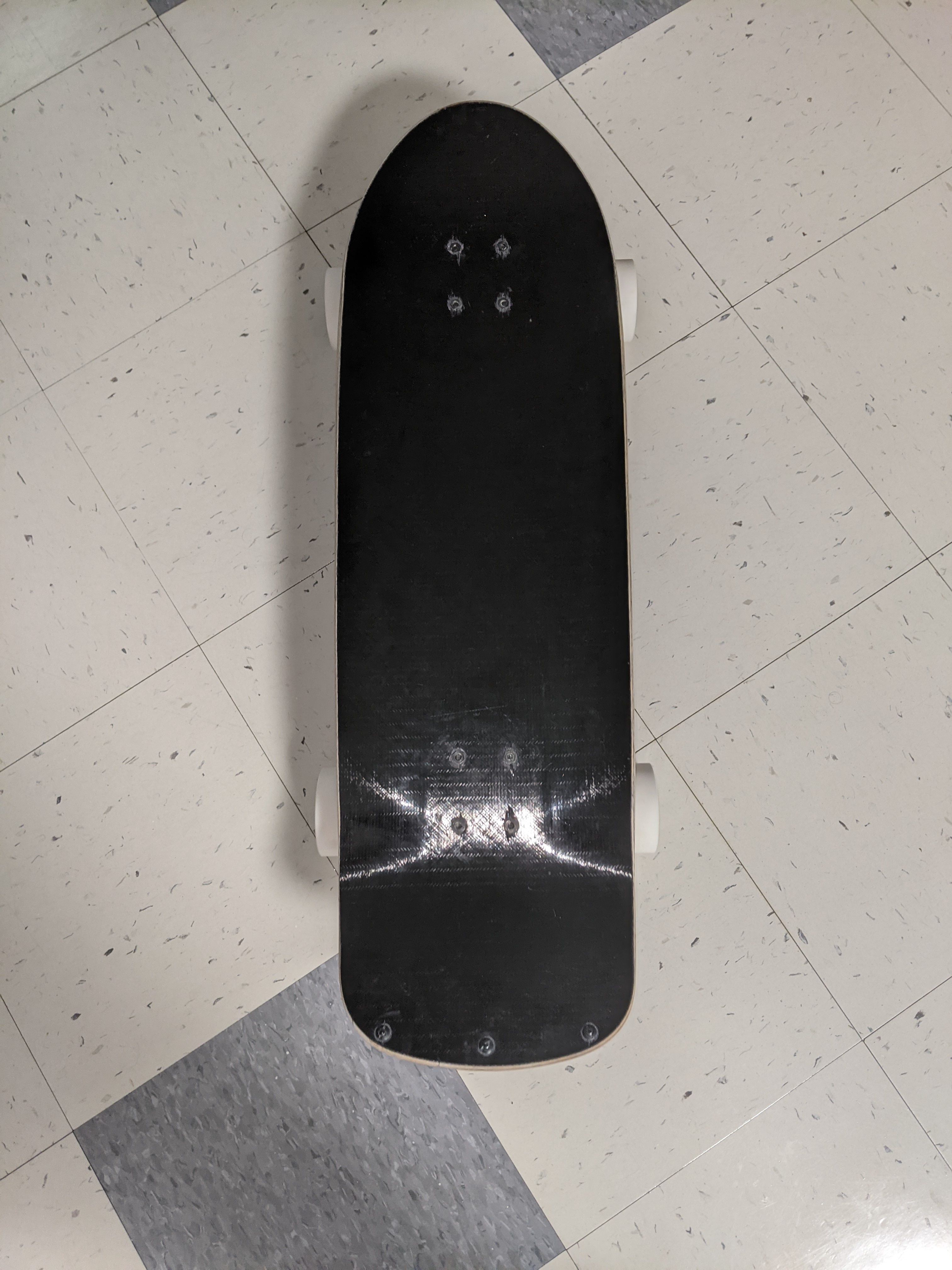

I made a new enclosure, just a hair narrower but 10mm deeper to give me the room needed for a 10s3p battery and random components. Also added in the Janux heatsink.

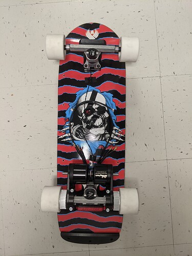

Tried out the SR TKP mounts with AHMYO wheels to check for wheel bite and feel. Going to change up the bushings a bit, softer (93A) on the front (barrel and cone) and swapping from a barrel to cone streetside on the rear (sticking with 96A). I’ll probably have to play around with it a bit as I’ve never ridden SR TKPs before, but so far like the feel.
Tested with 5/8" in risers (1/8" for light riser plus 1/2" riptide wire mgt). With this deck and complete lean I wind up with over 1/2" of gap. Obviously subject to change as the bushings break in a bit, but I think I will be dropping it down to 1/4" or 3/8" total riser height.
Tested out different motor mounts and had to stick with the Whooshboards ones. They’re just a little complicated for my tastes, but they’re the only ones that fit with my enclosure (probably because I made the enclosure based off their dimensions as a factor, duh).
I went with old school sex bolt/rat nutz jbwelded into place for all the through holes. Also got the tubes in place to house the rf antennas for metr and receiver. And yes, I bolted on a Powell tail bone.

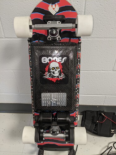

Last piece will be to replace the shoulder bolts that SR TKPs use with the Boardnamics axles before aligning and fastening down the mounts. Then wait for my new battery to arrive so I can bolt on the enclosure.
I felt a bit dirty covering up the Ripper with the enclosure, so had to add a sticker.

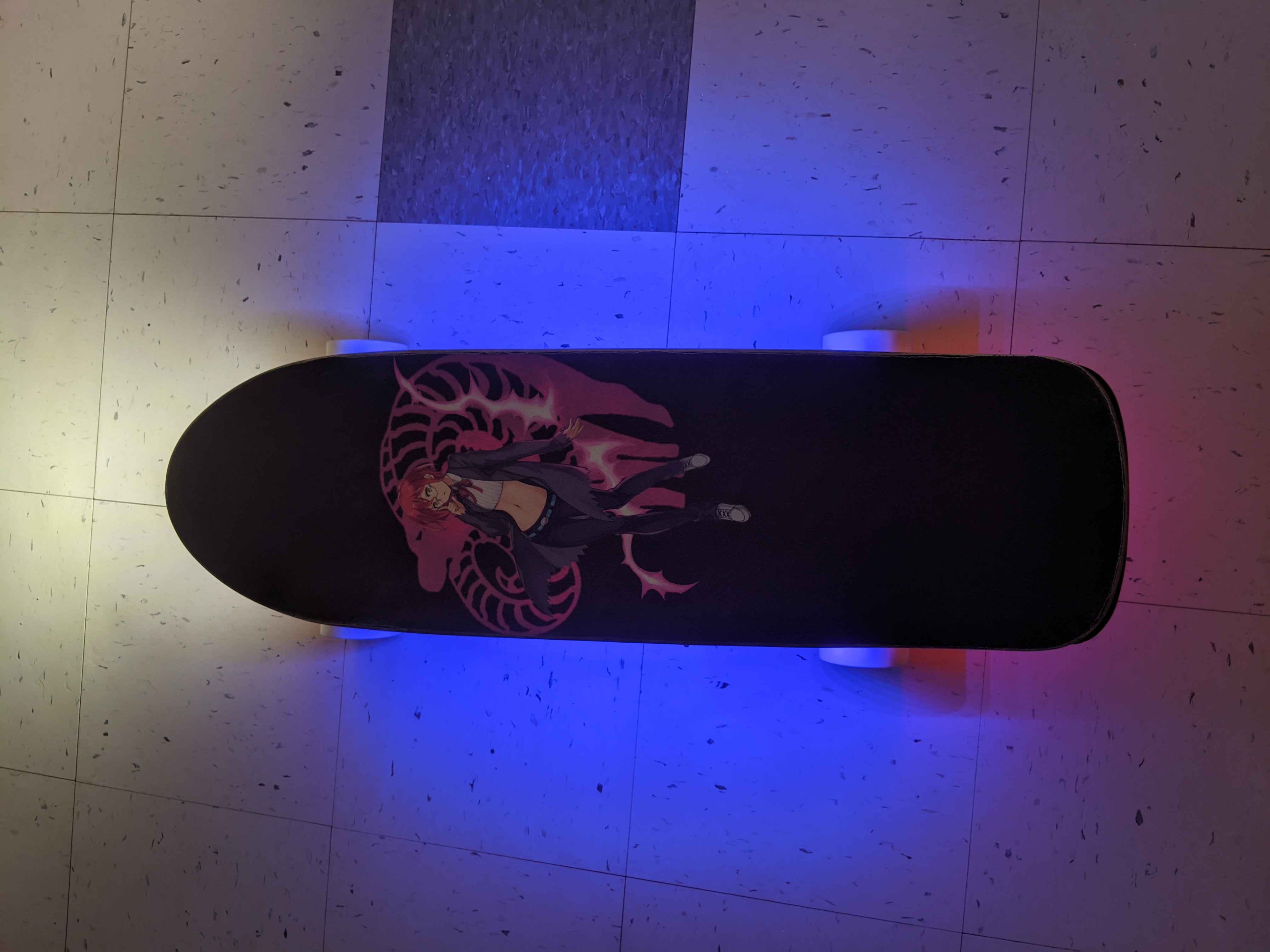

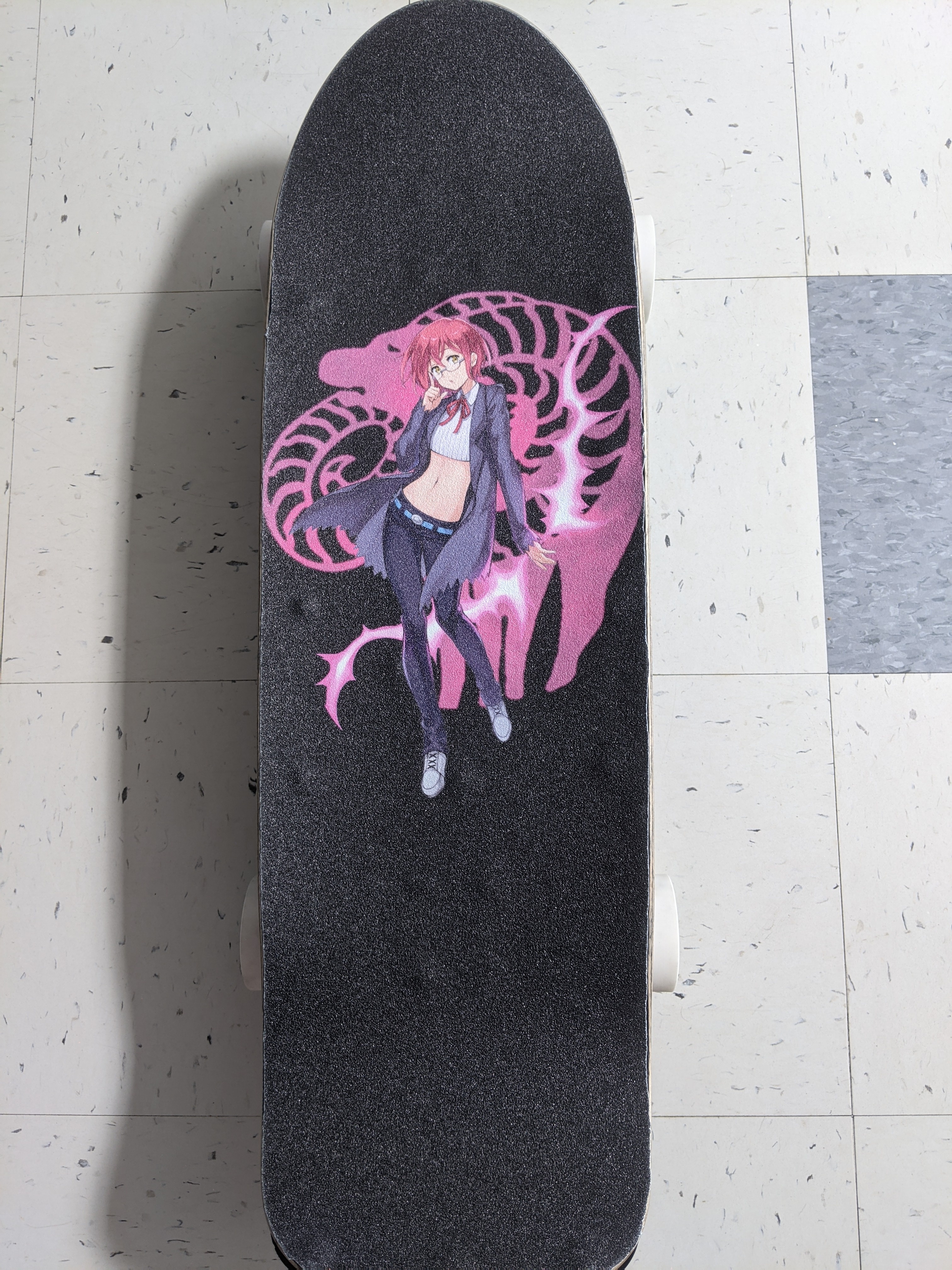

Everything is working smoothly although I will have to be completely insane to ever reopen the enclosure. Overall, couldn’t be happier with how it turned out. So last piece is the deck’s link to the name…

Lights… Camera… Action…
A quick post-mortem on the build (or “things I have learned”):
  1. Surf-Rodz TKP trucks are incredible. Great ride, fluid turns.
  2. SR TKP truck hardware (axle & kingpin) are crap for Esk8. Pretty much have to take apart the entire build to change anything.
  3. Being able to order something on a website does not equal in-stock.
  4. Have backup plans for the small, “inconsequential” things that you won’t have when the build is 99% done, such as the 290mm belts you have been waiting a month on (see #3)
  5. 15mph on a street deck is scary, especially while fine-tuning everything to reduce speed wobbles.
  6. 22mph on the street deck is exhilarating, even while fine-tuning everything to reduce speed wobbles
  7. (edit) UF campus sidewalks are crap. I’ll be putting on the Caguamas to compensate despite how smooth the AHMYOs were in general.
I was hitting speed wobbles around 12-15mph initially, but I knew I would be playing with the bushings to get this right. I still managed to get it up to 22mph after I settled in and started autocorrecting for the wobbles. Still need a bit more stability in the bushings though. Going to try barrel/barrel setup (currently barrel/cone).
I have a bunch of odds and ends coming to replace the hardware on the SR trucks and throughout the board. Most notably the kingpins, so I don’t have to dismantle the entire board to replace bushings and the axles (if they ever arrive). I am also moving the rear truck back about 1/2". This will give me a little more room for the motors with the enclosure as well as make the ride a little more stable as my back foot will be closer to the nutz. The only drawback is I won’t get as much bounce from the kicktail, but this build was never going to ollie anyway.
