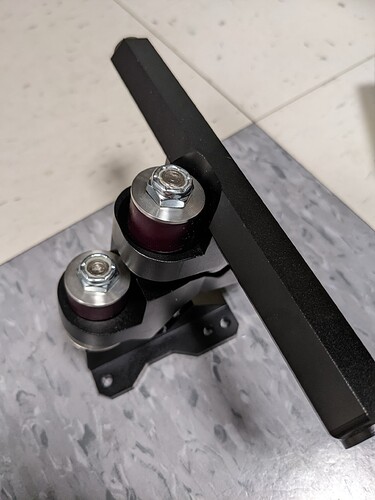

I noticed something in this pic. The roadside bushing cup is making contact with the truck. You can see the small silver indent.
I honestly didn’t design for precision cups there, but I can’t see how the boardside would be compressing enough to rub there.
Looking further, with the design, I can’t see that as being a rub. The kingpin is fully extended and it would take the aluminum of the secondary bushing/pivot to bend/compress or the boardside bushing to compress over 1/4" to hit there.
@rafaelinmissouri any ideas as those are yours? Tool marks maybe?
